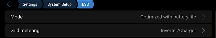

Hi,
How did you setup the grid meter ?
If you selected, external meter and you dont have one, your system behavour is “normal” (as it works actually). If you dont have external meter you need to select grid metering Inverter/Charger.
