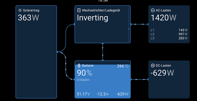

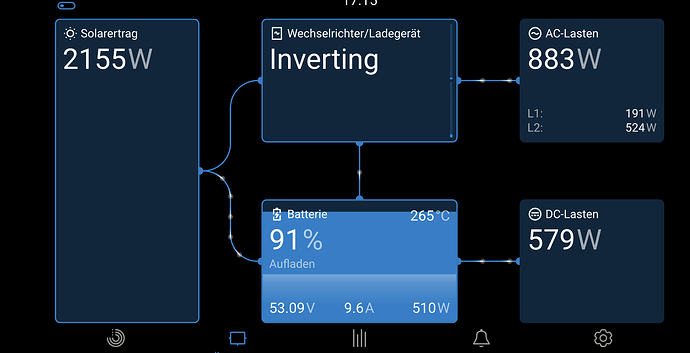

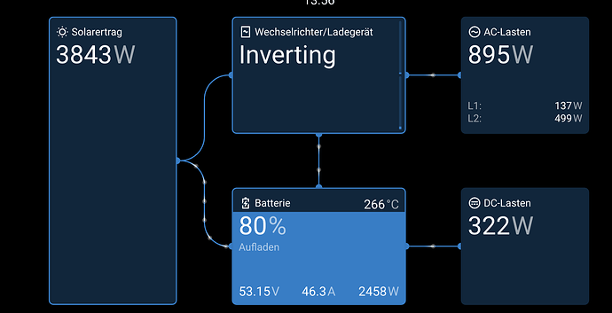

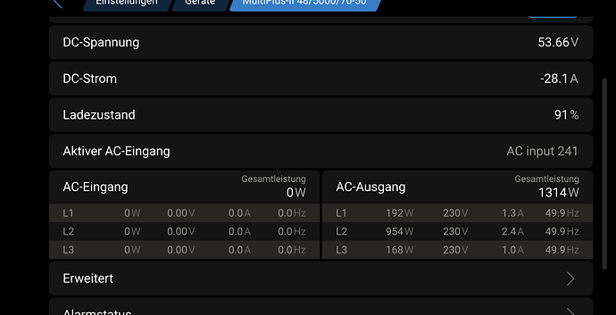

Hi,
after update to 3.63
the L3 phase is missiing in the overviews, in the details / devicelist is all ok

I experience the same with 3x 1p grid inverters Hoymiles HMS connected via OpenDTU.
Which phases are shown depend on values received.
Open DTU send for the inverter on p1 only value on p1. For inverter on p3 it send all three phases (p1&2 always 0W).
If only p2 has send an update, p1 is 0W, p2 the actual value, p3 is missing.

i made a reboot, same issue …

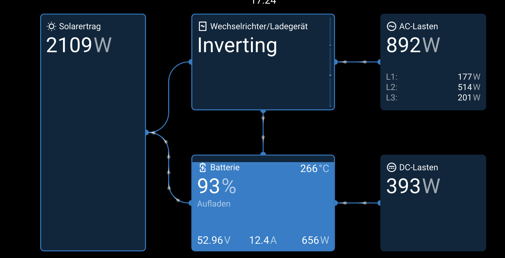

i switched now to gui v1 and in gui v1 the values are ok, all 3 phases.
if i go manual then to /gui-v2/ than its also ok
