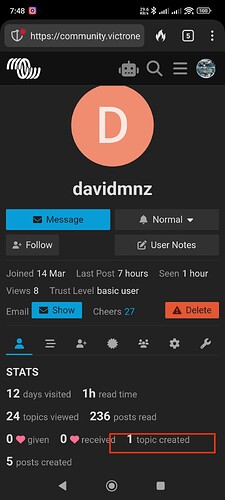

Just needed some clarification there. You have no previous posts showing in your history.

I think we have a terminology confusion. By “previous post” I meant something I had posted previously in this thread.

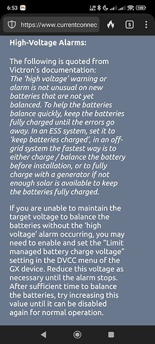

They consider their batteries charged at 55.2v (from their smart shunt set up guide)
Clamp it down around 55.5v in DVCC. And then raise it to 56.5v. Thier own manual recommended method for taming the warnings.is using dvcc.
Set a very short absorbtion time in settings (15mins) if you want to keep the outer end charged voltage programmed.

I read through the discussion, and my view is that the software from your battery is not good enough to avoid one cell going to high and you get an alarm.
Your battery should react actively and faster that one cell is climbing to the higher voltage, AND should regulated the CCL and/or CVL quicker to a lower level.
Best to ask your battery supplier for a new firmware version to solve the issue.
Setting a lower voltage will avoid alarm, but maybe the batteries don’t balance so good as should be.
