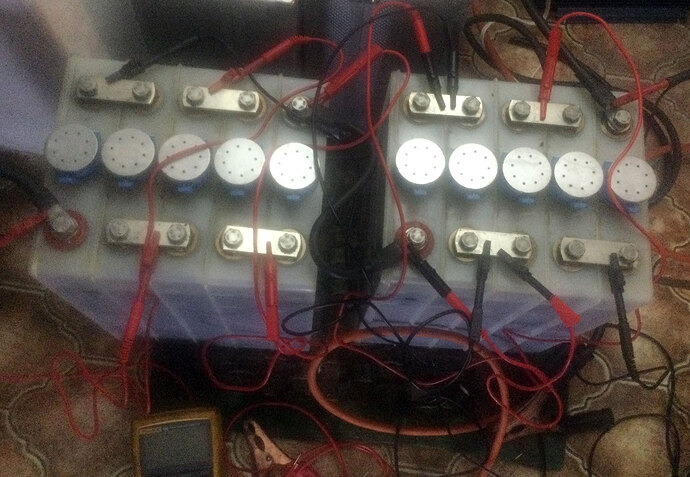

The batteries I am using are 2 nickel cadmium NIFE (now Saft) type M 304-5 connected in series for a 12V system. I cannot find the specifications for these specific batteries, but I guess 304 stands for the ampere hours and 5 the number of cells.
The “mess” around it is load testing using an inverter and a cooler box. It is powered by a 30V bench top power supply.
The charger I am using is a simple MPPT 100-15. More than enough for what this needs. Biggest loads are charging a laptop with a theoretical max power draw of 90W (which will never be reached) and the cooler box that draws 40-55W depending on the settings.
The system will be installed in a van with rooftop solar panels. One or two panels will be used (30V/8.5A-ish/245W each). One is enough, but two won’t hurt for cloudy/shady/low light angle situations.
First load test shows me that I have not been able to charge these batteries even close to full. They have been unused for a few years so they might need a commissioning charge. Settings for that also appreciated.
I’m doing a constant potential charge at 1.55V/cell not exceeding 0.1C A (which my setup cannot reach anyway) for a minimum of 24 hours as recommended by Saft.

The individual cell voltage currently range between 1.45-1.56V. Most of them are around 1.55V. Still doing the commissioning charge which will last at least until tomorrow.
Does anybody know if they will self-balance when charged in series? I have read that charging in parallel can be problematic, but have not read of any problems charging in series.
Just a small update to document my “journey”. Hopefully the information in this thread will be useful for others that explore nickel based batteries.
I did an almost full commissioning charge and the capacity of the batteries increased significantly. The load test showed a 3.7 times improvement. But the cells are still uneven.
So now I am discharging the batteries to 0 volts. I first discharged both batteries in series using a light bulb. After that some cells are almost fully discharged, some are not and some have become polarity reversed. I discharge the cells that have a higher potential using the light bulb until they read reasonably low. After that I short them out and keep them shorted for 24 hours. This is all documented in various manuals.
When each cell reads 0v I will do a new commissioning charge.
Apologies for the grainy picture. It is a dark rainy day with not enough natural light for taking good photos.
