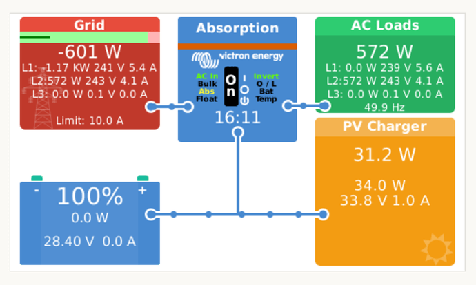

My 24V is fully charged. I have 2x 12V panels. You see, I get just above the 5V needed to start the MPPT when they are fully charged.
