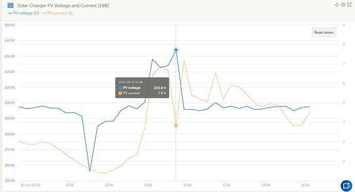

Looking at the log files max voltage spike since installation has been 233v. Never got to 250v. No warnings or errors on anything since install.

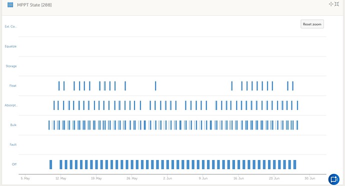

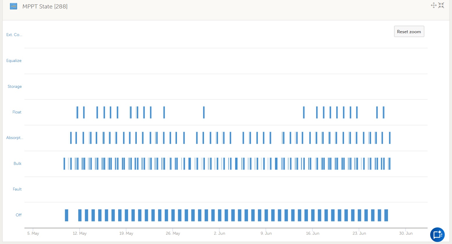

Here are screen shots from the logging. At no point it went over 250v. The logging is a bit average only being able to record every min. My last system I could log every sec. When it blew up was floating just under 200. If it did get a little spike it cant have been much. I cant beleive there have zero tollerance and zero protection. No warnings the whole time its been running.

About the voltage logging. It’s never as good as an actual real measuring instrument, due to the intervals.
If you use the online version you can search a huge database under custom with your panel and it will populate it for you. Also, click the cog on the wodget for details to show actuals and you may see when it exceeded 250V not forgetting VRM logs at best 1m intervals so a spike could be missed.
