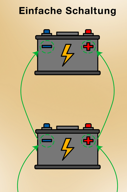

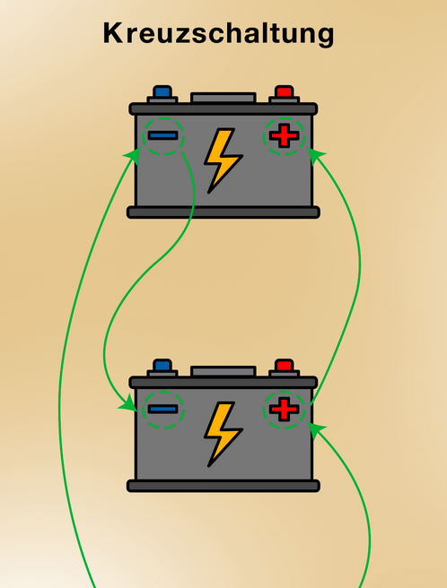

Hallo chrigu
parallel cross connection:
A cross connection is better for batteries connected in parallel.
Thats the same as above. And i dont see a cross, but dosent matter.
If you have your batteries connected like that, then choose one to readout with the smartSense
