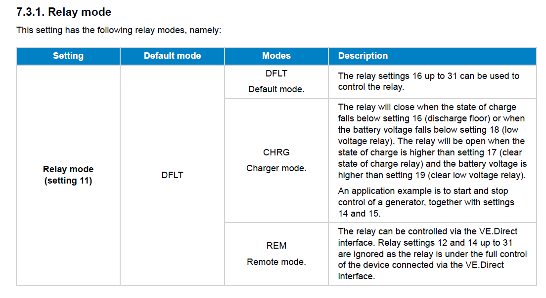

I have not used the BMV-702, but I know from reading that it has a relay. You could use the SOC function to turn on the remote of the DC-DC charger. This will allow you to charge the battery from the alternator when the SOC is low, allowing you to get as much from solar production until it drops. You can also use the relay to stop the DC-DC charger when the SOC is, say 90% and let the solar finish it off. You only have problems charging from 2 different charge sources that are not communicating when the battery is near full.
