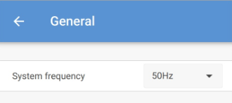

VictronConnect APP v6.23:
System Frequency changed to 50Hz
Enabled accept wide input frequency range.
Settings were applied while the unit is on DC power only. Once 120V AC is applied the MultiPlus-II will not accept the input. (See below)

Yes, I have tried charger mode only. I did notice that when using Ve.Config the option to set the frequency does not exist like it does with the 230VAC MultiPlus-II units. See below sample of a MultiPlus-II 230VAC
and the MultiPlus-II 120VAC
No System Frequency option.
“system frequency” is only for the output in inverter mode.
