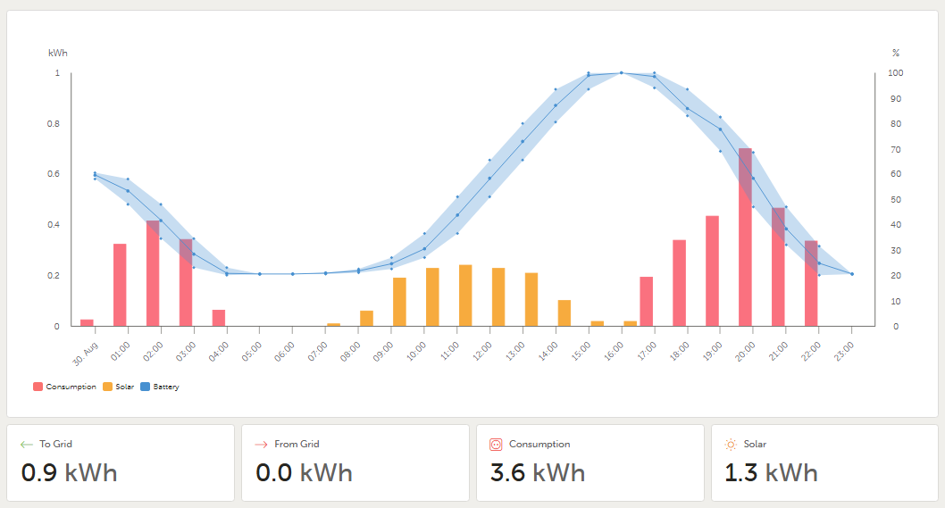

I run a 12V 1200VA with about 380AH or 4kwh of battery connected ATM. Its a good fit. I charge and discharge it everyday using ESS and DVCC to limit the charge current and time of day it charges to soak excess solar and maximise the small array. It is only small but I can scale it depending on what I am using the batterys for and how much energy the house is using. I sometimes have up to 10kwh of 12V batteries connected.
