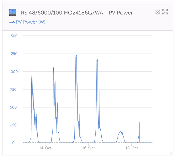

They are saying that the startup voltage is 120V, but in fact is around 90V. You can see by looking at the graphs on VRM.
Once the MPPT is started, it can go as low as 65V, indeed.
