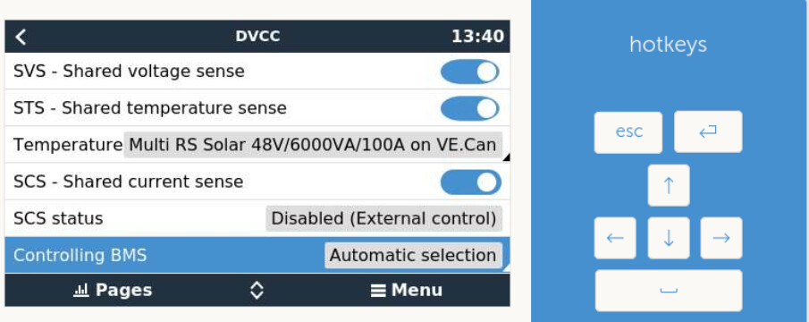

Anyway, the cerbo detects it and tells me what BMS it is, but the charge state only says “EXTERNAL CONTROL” Do you know if that’s an issue with the BMS or the BMS isn’t compatible? I would love to know if it’s possible to get the 3 / 4 states back BULK | ABSORPTION | FLOAT

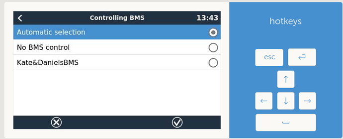

Yes. Remove external control from the battery. It can be done in DVCC (on the cerbo). Just be aware that on the multi rs you will have to reset bms control with victron connect.

Remove bms control in the cerbo under dvcc
“External control” effectively means the Victron gear is using BMS supplied values for charge voltage and charge current to the BMS.
If your BMS is a good one and is set up correctly, it should mean finer control, reduced charge current with low cell temperatures, better balancing etc.
If you’re not sure of that then as @lxonline says, stop using the BMS for that - but you might have to, for example, reset any MPPT in the system (…)

So there should be no option if you are on newer firmware to remove it there or set it there if you want to monitor the battery but not let it control the system.

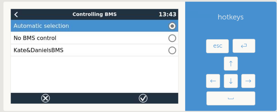

Ok so I selected the No Control BMS and it stopped charging the batteries - Better check for firmware updates
Yes because the inverter had a signal and now doesn’t. So as a precaution it would have stopped.
You have to reset the inverter to no bms control using bluetooth and Victron connect. And program it accordingly with the voltages etc.
Your bms appears on the list there though. So you should be ok if it is compatible.
