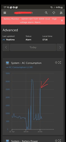

Afterwards i checked the consumption data and it only peaked at 2560w at that point of tripping the mixer into the barrow, yet it struggled. Is this normal for an induction motor, could i blow up my inverter if im not careful?
