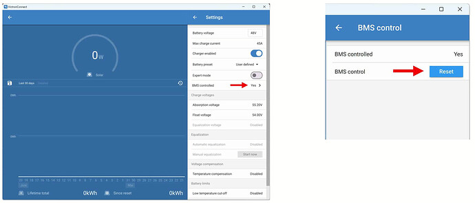

Reset BMS controll in the MPPT Charge controllers with the Victron Connect App: Settings → Battery → BMS controlled → BMS control Reset
