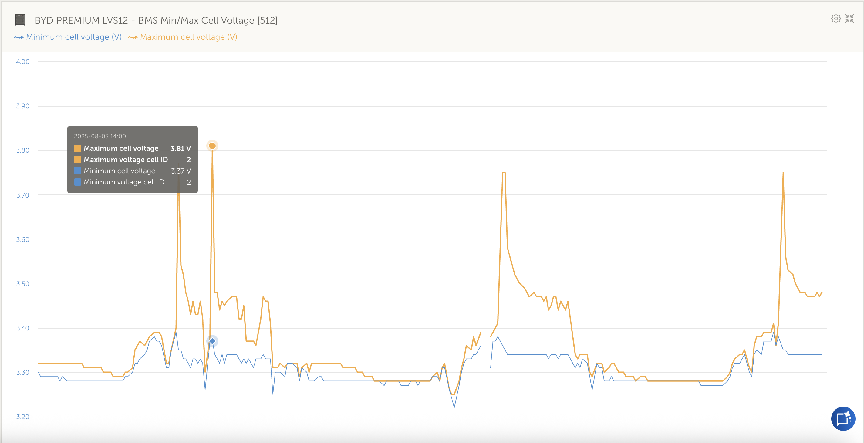

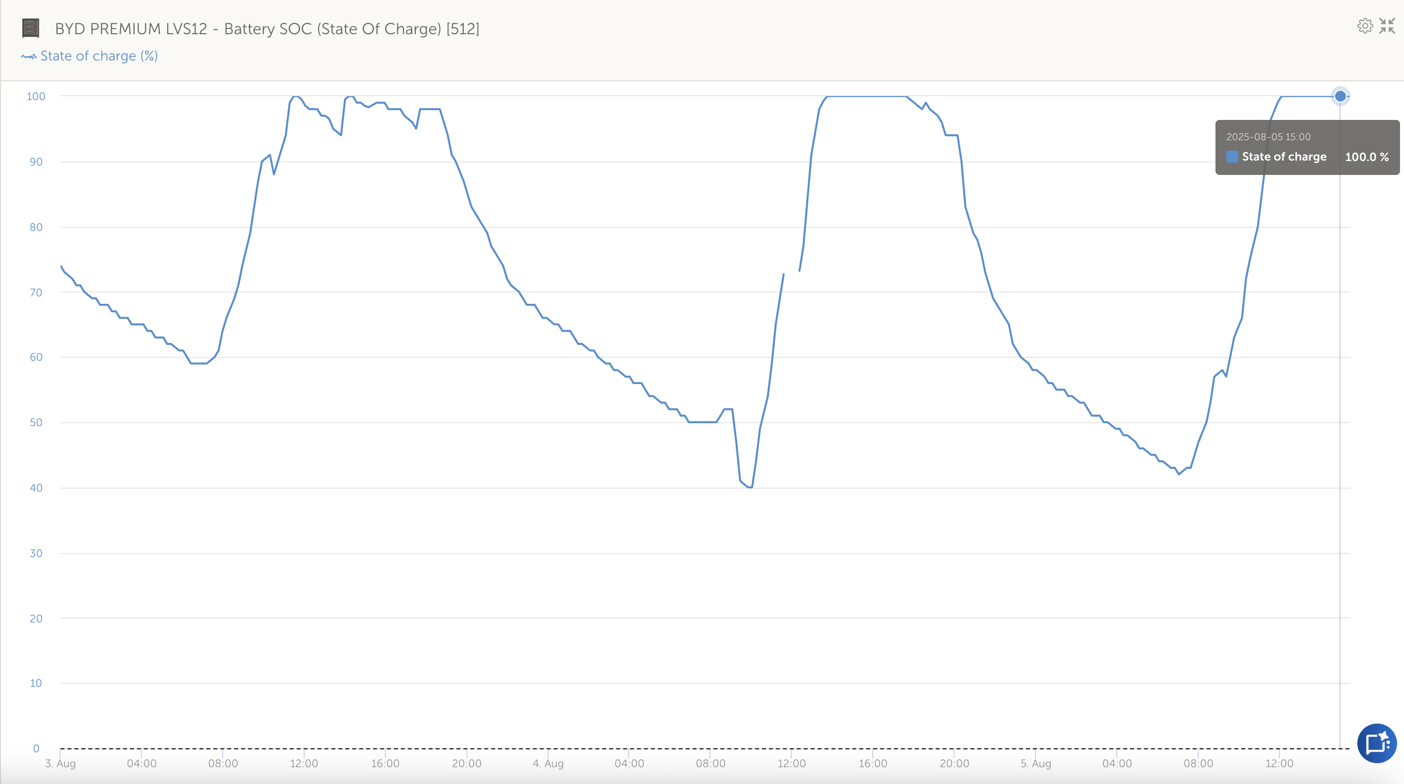

I have the BYD premium LVS12 (3 modules of 4kwh) and I always get the warning everytime the BYD battery reaches 100%, going away after some minutes even and battery fully charged:
Can you see the cell number with highest voltage?
@ 60-70% SOC is this the same cell?
Seems to me the balancer isn’t working, resulting in one cell more charged than the others.
It can also be a bad cell but you first have to top balance (within a few mV) before you can check.
A high cell voltage warning when BYD batteries are nearly full is somewhat normal, as long as its a warning and not an error.

BYD’s work well. They adjust their CVL based on charge level.
Unless something is broken, standard settings should be fine if provided sufficient opportunity to charge.
Like any battery if it isn’t optimally sized, and is unable to properly charge regularly, there will be problems.

The pack will drop the CVL when thresholds are hit. That should be sufficient to prevent anything happening. Their systems work fine and are enormously popular. I only see them mutter when heavily discharged and not fully charged for some time. They sort themselves out quite quickly once allowed to charge.
Yes, but without proper top balance, you will get the error every cycle.
And it seems the internal balancer isn’t capable to balance the cells.

Have my own as well, cycled properly, not always charged fully each day, no issues.
Two warnings (not alarms) this year, and it had not been properly charged for an extended period. One decent cycle on “keep batteries charged” sorted them out.
