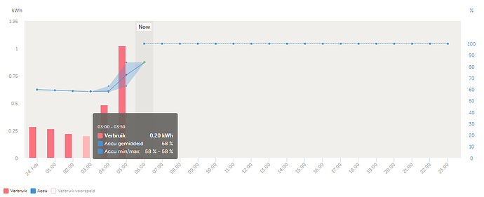

This is what I mean.
At the moment it is not the cheapest hour, it decides not to take the load…
