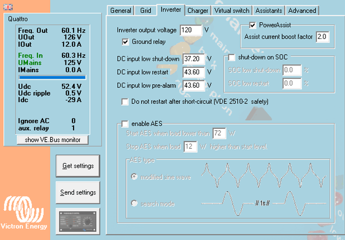

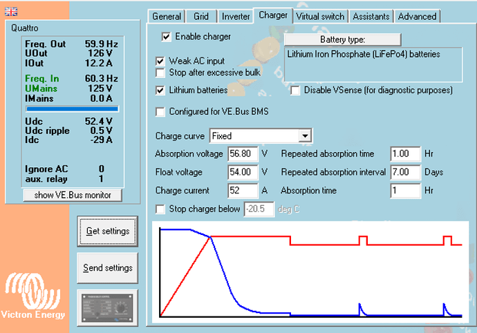

The generator signal seems to be acknowledged in the Monitor but it isn’t doing anything with the power, namely charging my batteries (2xEG4 14.3kwh) or powering the house.
Here’s my frustration. I have tried 3 different generators now. It should not be this impossible to hook a generator up to a Victron Quattro. These are supposed to be quality. I have used cheap renogy and generic auto parts store inverters just fine with generators. Why does Victron suck so bad? Or is this an easy fix?
Btw, I am reading 125v at the Quattros AC input from the generator.

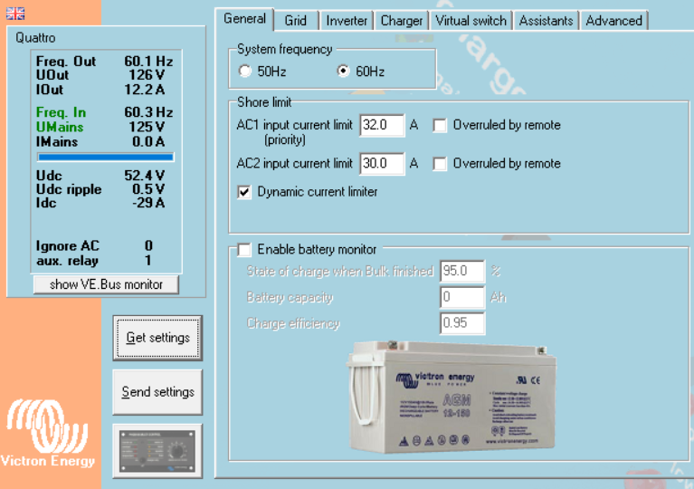

However, you may be able to uncheck the “Switch as Group” option in VEconfigure so L1 is powered by the generator and L2 is powered by battery/inverter, if you think that’s a good idea.
Also lower your ac input current limit you can’t pull 32a from a 30A source. (And it will try).
Aim for 80% or probably less depending on where you are above sea level.
