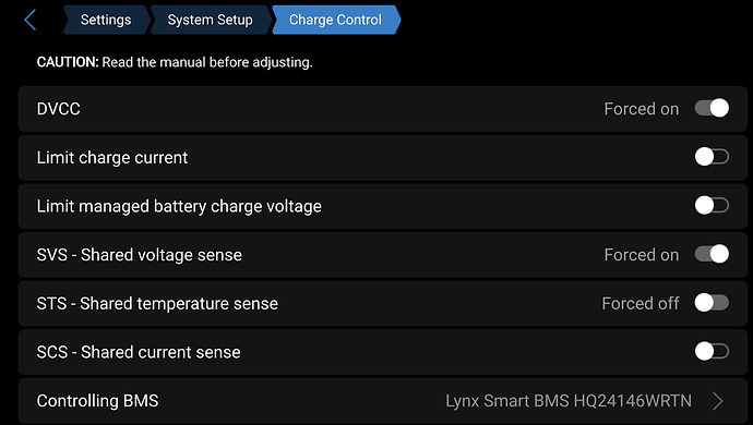

As above, remove any setting for “limit managed battery charge voltage” DVCC so it charges to 56.0V.
yes; I removed also from here

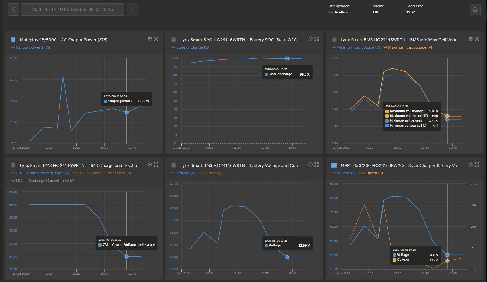

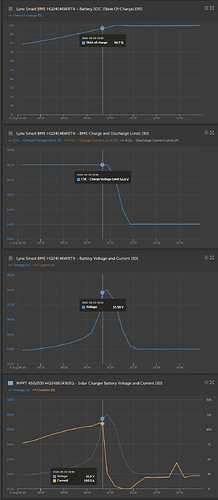

Seems to be working!
Although I promised to perform a test, I didn’t want to changes the settings again (it is a real pain in the a$$ to search for the right settings in different places) so I let it run with the ‘recommended values’.

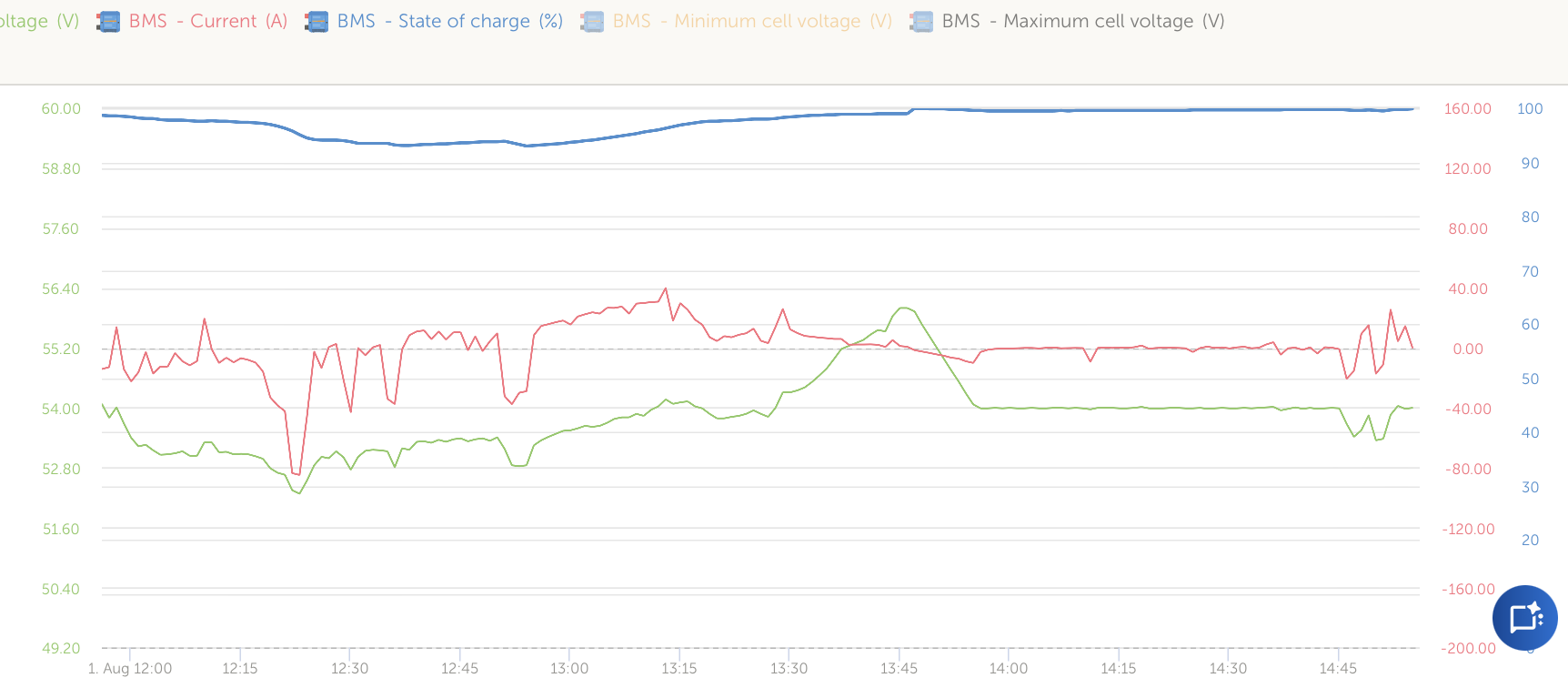

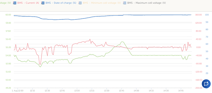

It sync’d nicely around 13h45m.
It also did not have a prolonged absorption time.

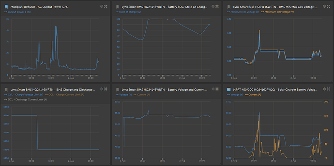

I ran for 6 days without an absorption going down to 45% and used about 1000Ah from 600Ah of batteries over that time and the cells were still balanced, only 3 mins at 14.0V, just enough time for the sync to 100%.

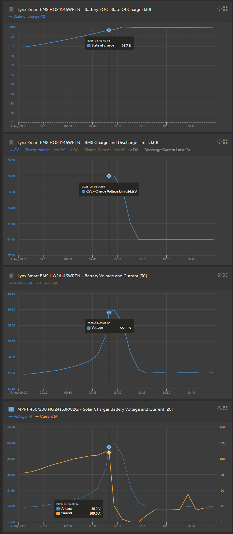

I already run months with the voltage limited; so no absorption. Never saw unbalance.
I see that your system had a very short peak to 56V and then sync’d to 100%. Congrats! :handshake:

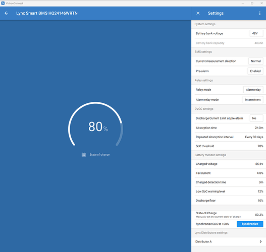

Because “charged voltage” was set at 55.6V sync will only happen every 30 days (Repeated Absorption interval) or if voltage reaches these 55.6V.
For the voltage to go that high, I need to trigger absorption.
If I want sync to happen daily (which I want), I need to reduce the “Repeated Absorption interval” to 1 or raise the “SoC threshold” to a value which I know it gets to every day, for example 80%.
The problem here remains. Sync to 100% is attached to absorption, and absorption is on a value I would prefer my batteries would not reach.
Victron must allow lower absorption voltage; I understand not allowing raise it, but lower it and not using full capacity, is my right!
I changed my settings for now to 80% and 3 days for 5 minutes.

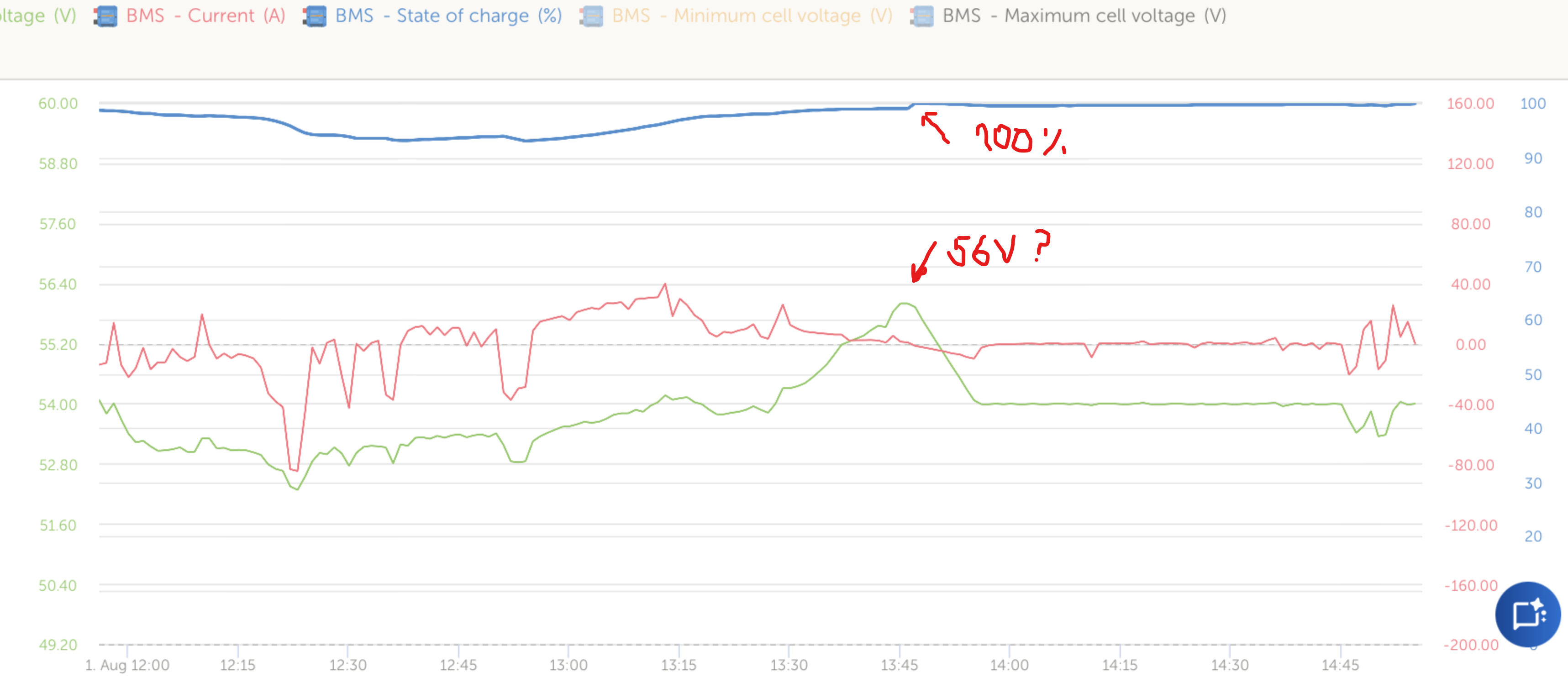

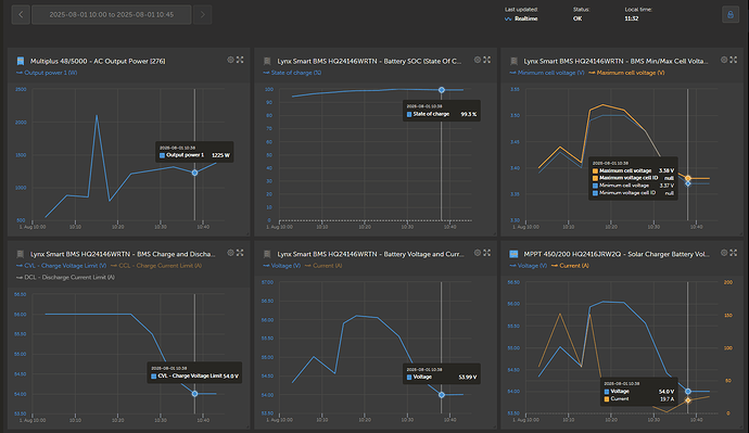

@zedamoca I believe you get one thing wrong: sync is not attached to absorption. I had it sync properly last two days using “charged voltage” set to 54.9V and “maximum charging voltage” set to 55V. That was the test I accidentally did. So you can use it at a lower capacity, though it would never balance.
See the short green peak in this image:

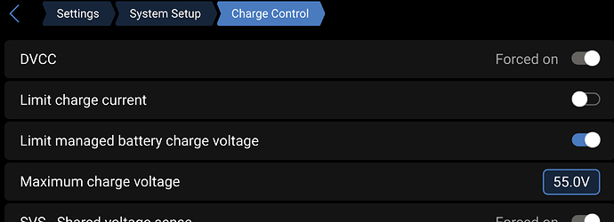

Where do you see “maximum charging voltage”?
From your screenshot

Yes, 100%, no, 55V. I made sure the axis were on the image, but still not visible?

I’m an idiot, I was looking on other screenshot of you…
[quote=“hennephuis, post:57, topic:36747”]
I see it on the console gotcha.
