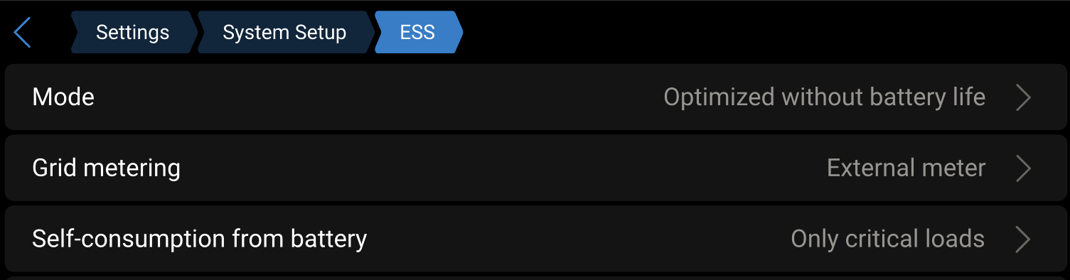

Yes, you need to put the ev charger on AC-IN, use an external gridmeter and set self-consumption from battery to only critical loads.
ok thanks, but would that work even if I have my entire house powered from AC OUT? I do have a ET340 ready to be used…if I set its L1 to read something that would be great, right?
If you put the charger on AC-IN you have a choice how to charge the car. self-consumption on all loads —> charge the ev from the battery, self-consumption on only critical loads → charge the ev from the grid.
