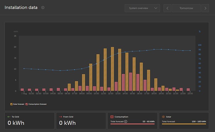

I will show tomorrow’s forecast and it is at least 100% under estimated, then tomorrow I will put in the actual data for comparison.

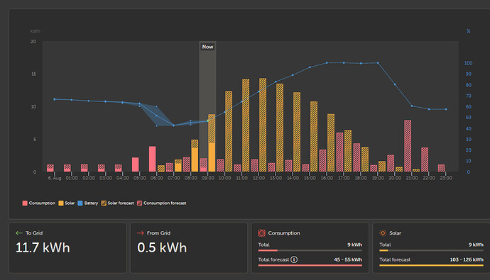

Here’s the solar forecast for my test DESS system:
Same for solar forecast. It uses blocks of four square kilometer of your location, and it has no clue about information about azimuth, kWp, shading and what not. That is exactly why their AI scripts need to learn this from your data over time.

I understand that the system needs to learn and then fine tune itself until it is top notch but the variations are still very large . Today he gives a forecast that is 3 times too large . see graph I will wait a few more weeks and see what happens thanks in advance for the support.

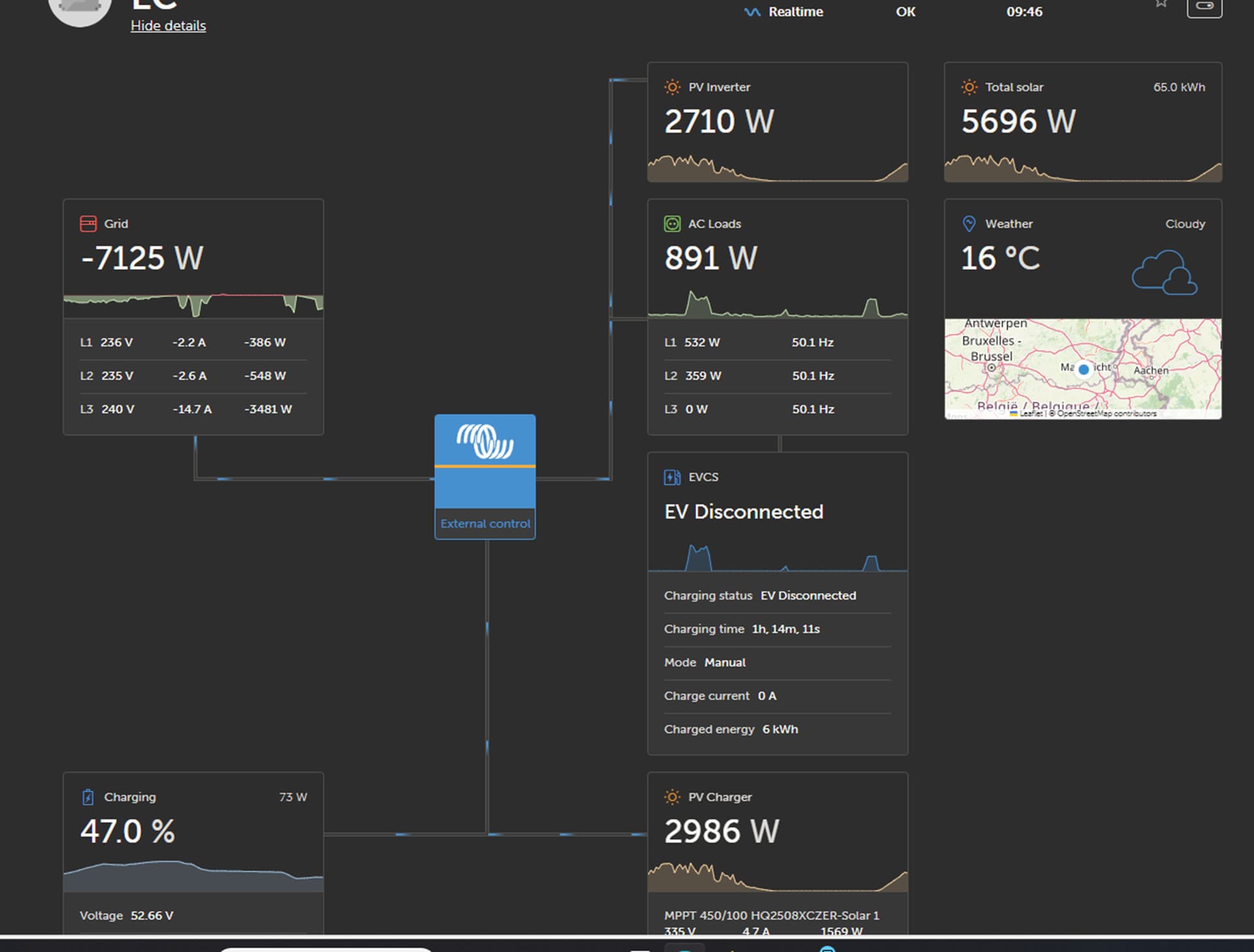

I can give another update on the installation,I replaced my huawei sun2000 4.6klt with the Victron MPPT RS 450/100 this was done 2 weeks ago. I thought the system would be better now as it recognizes all the devices and can communicate with them.This was not so with the Huawei.
I could see no wrong with the values I can read from my SMA inverter and my Victron Mppt 450/100. The values I read in the VRM portal match what the installation is producing.
