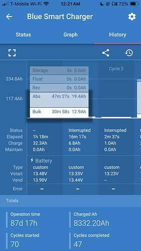

First, screenshot showing how long ago the charger switched to absorption:

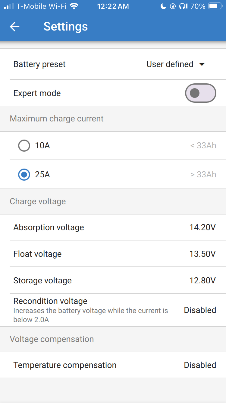

Third, screenshot showing Absorption voltage setting of 14.2V:
