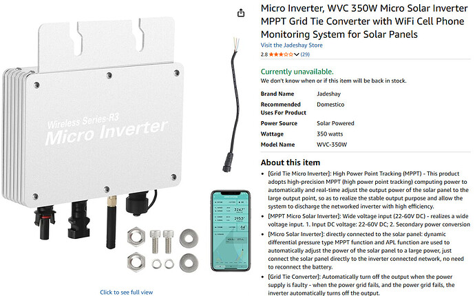

In the mean time I retrieved my amazon order just to check the model of my icroinverter.
In the manual I found no mention about frequency shifting but someone else but someone else might have used it.
Adopting another/opposite approach what would be your suggestions for a brand new microinverter that match perfectly with a Victron MP2 inverter?

Hoymiles is what I use and they are fully compatible with grid-tie use and support frequency shifting from Victron. They sell Euro versions and work really well. Have fun!
