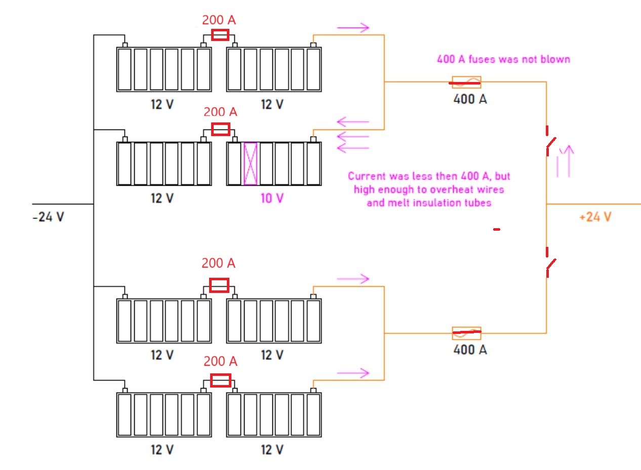

Please, I need opinions about fuses MRCB or MRBF+ switches?

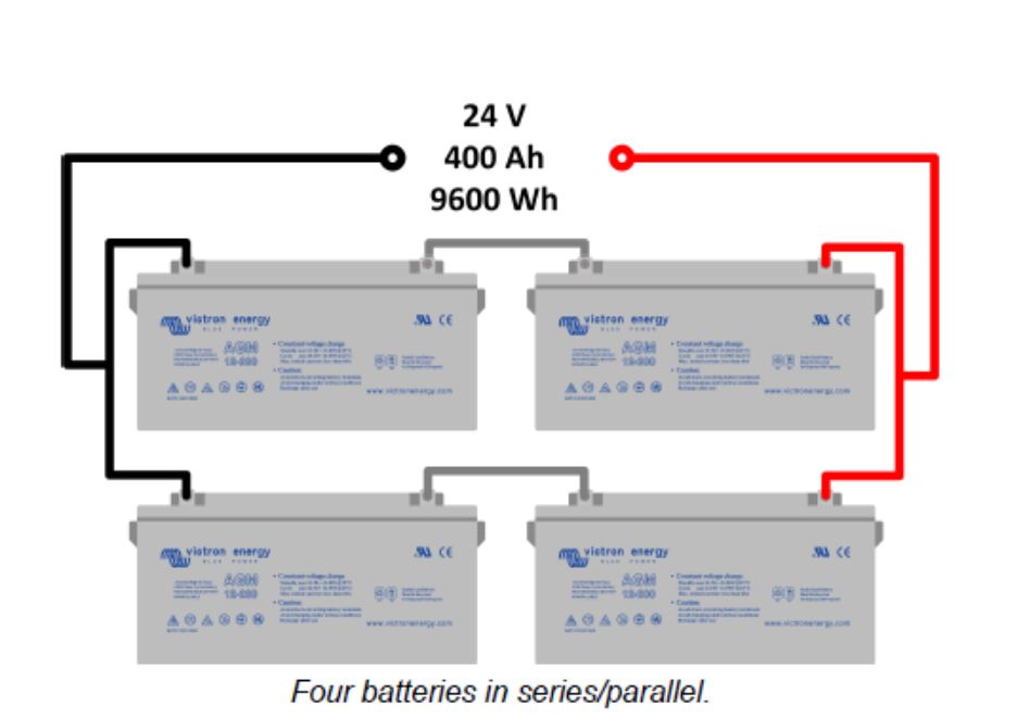

Interesting, that in Victronâs great book âWiring Unlimitedâ I found 24V battery bank connection diagram exactly as I had before, without any protection against single battery short circuit.
Can it be, that I am overreacting and no protection is needed?
How do you like this solution? The fuses are half as valuable and will blow more quickly. A catamaran is predestined for a redundant solution. There are actually 2 battery banks that can be switched individually or together. If there are problems or maintenance work, simply switch one offâŚ
Yes, I am thinking about similar solution. Thank you
I want to be able to quickly disconnect any of four pairs. Thinking about 4 MRCBs, but many advise me not use them.
