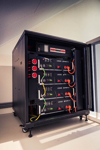

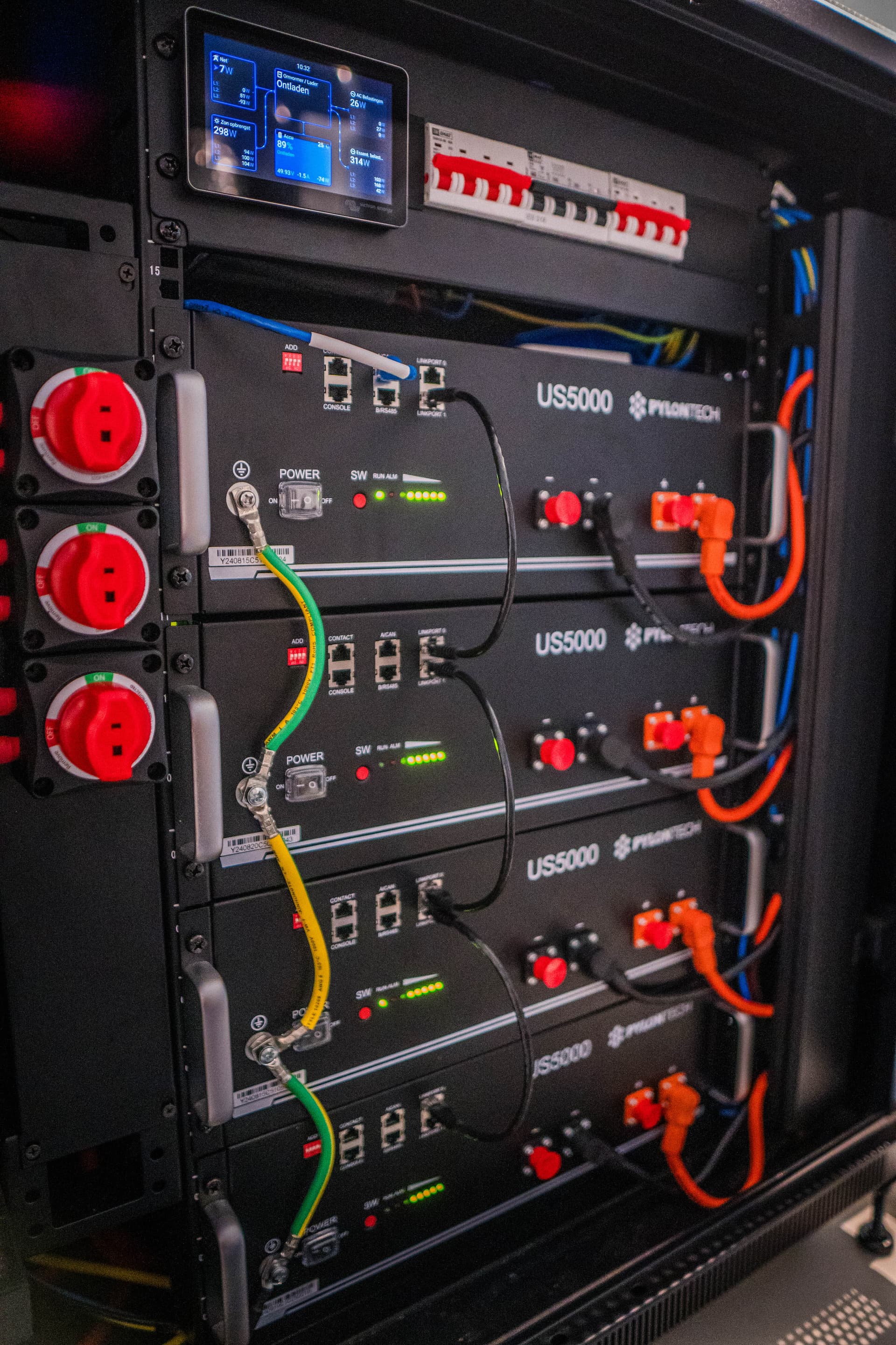

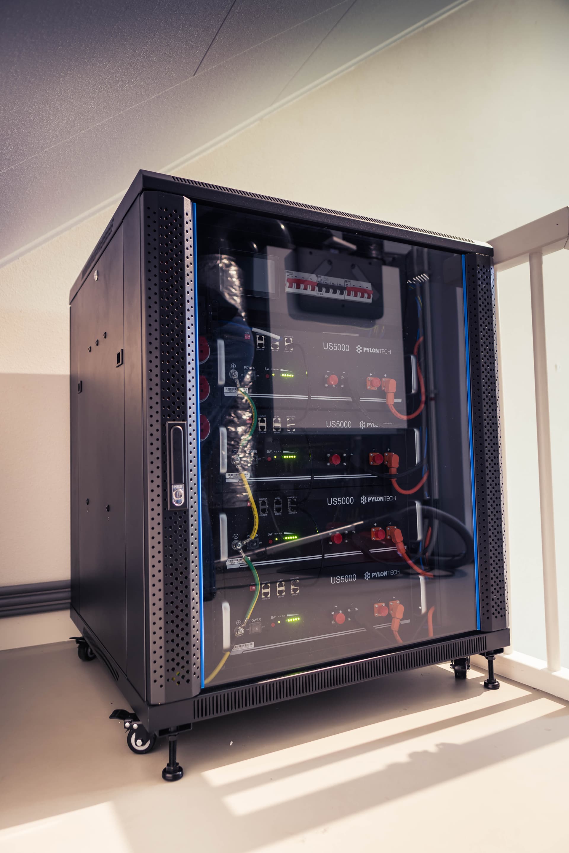

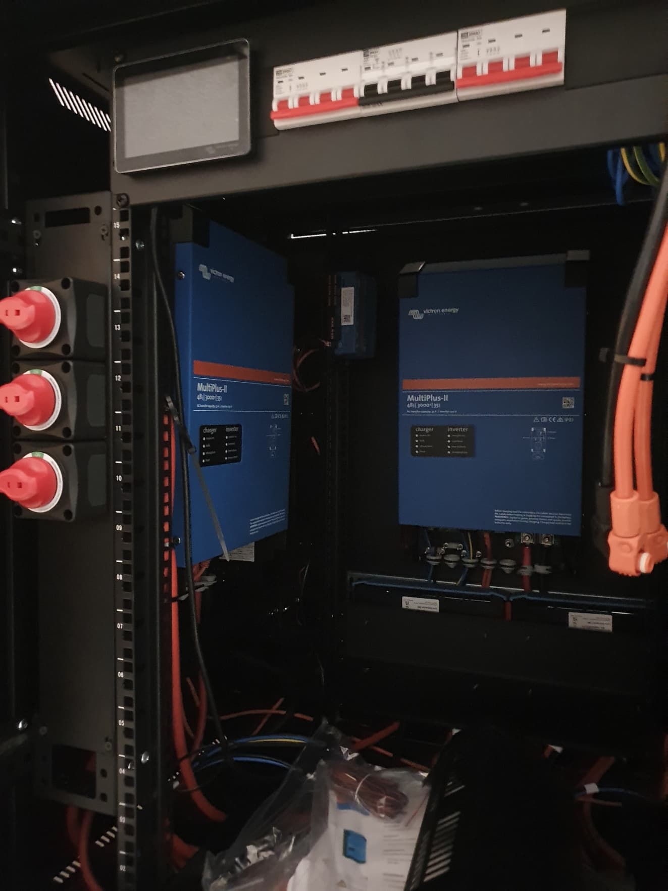

Hi! I just got a ESS system installed, most of it is great! What I’m not loving is the constant humming sound of the transformers. What can I do to reduce it? I guess most of the sound is resonating in the cabinet where it got installed. It is located in a server rack with the 3x multiplus II 3000 on the sides and rear of the cabinet.
there is no dampening what so ever. The multiplusses are mounted using the wall bracket, the wallbracket is screwed into the metal case. So it is metal on metal with a big resonating chamber that is the server cabinet.
what if I mount the wallbracket on rubber dampening mats like they use for washingmachines. should this shave a few dB’s off? or do I have to decouple the toroid from the housing.

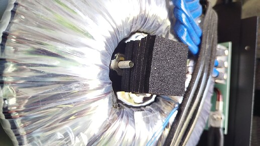

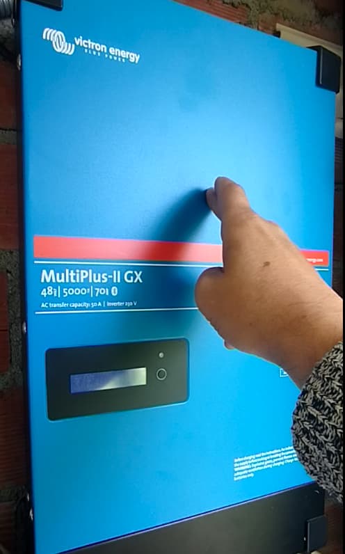

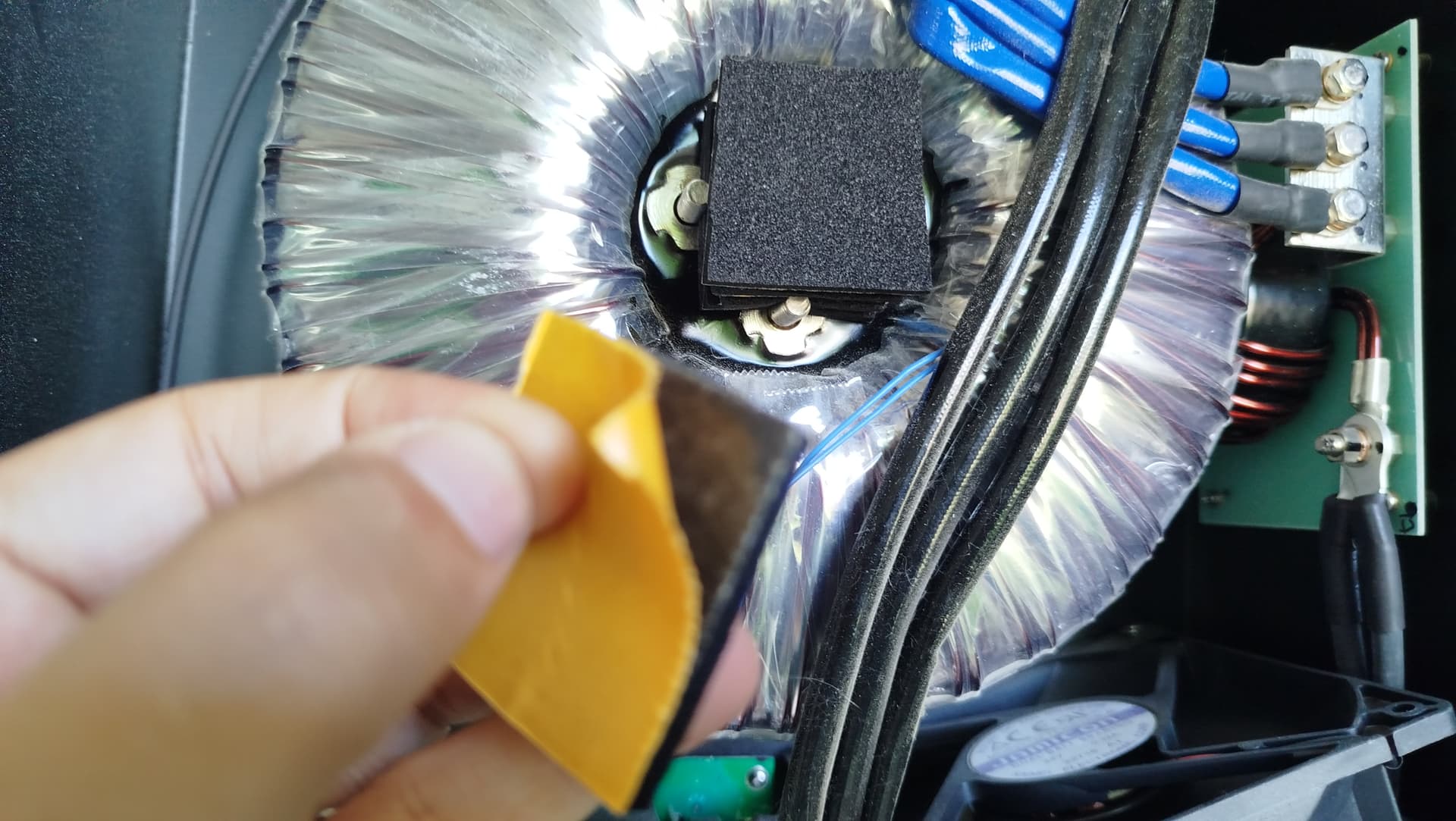

My problem was similar; I solved it with the cover resonating simply attaching adhesive sponge rubber on the center over the copper transformer (Victron engineers, take note!).
With certain loads, the case was huming like a angry cat, but if I tapped my finger in the center on the case, it made evident that the problem was the vibration of the cover (and the screws were firmly tightened).
Check out the photos. Now the system is silent… happy again.
With a wooden slat chequed that the rubber was going to put enough pressure on the cover (but allowing its placement).
Cheers from Spain.
(Victron Multiplus II GX on single-phase with 5 kW PV and 15 kW lifepo battery)

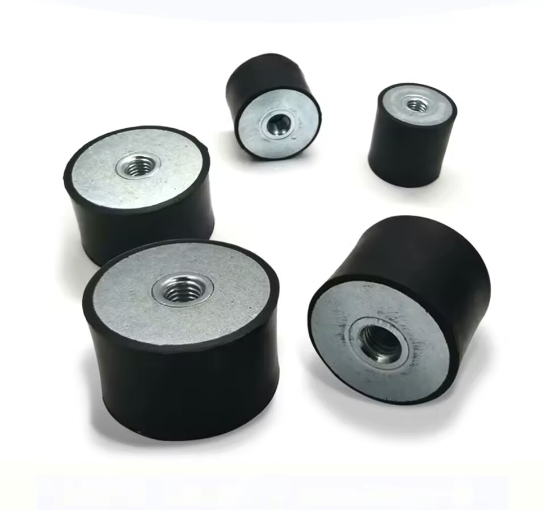

I have used these dampers from aliexpress. 30x30 m6.
Before the humming was transferred to the wall and hear able even outside the technical room. Now it’s nice and quiet. Only on full power sone noise is noticeable but far less than before.
https://a.aliexpress.com/_Ezq8Fqq
I used a self-adhesive sound dampening mat on the inside of the Multiplus cover:
Wat also helps against fan noise is to isolate the metal fan mounting bracked from the case with a strip of eva foam.
To isolate the Multiplus from the wall I used rubber pads behind the mounting bracket:
Hmm. Correct me if I am wrong, but this kind of dampeners is usually designed for axial compression forces (sometimes also for tensioning forces). As in a weight (force) put onto the (inserted) stud. For example to put a airconditioning outdoor unit on top of four of them. But now you are hanging your 30KG Victron Multiplus, as a tensioning radial load onto them. Something like 300Nm in total to be precise.
Sorry. I don’t know, but that doesn’t sound like a great idea.
Actually I also have seen some examples of using them sideways. And I can confirm this works fine. The dampers are very strong, I really did some extreme stress testing on them and they didn’t break. I use 6 of them per multiplus and I’m 100% sure they won’t break down.
