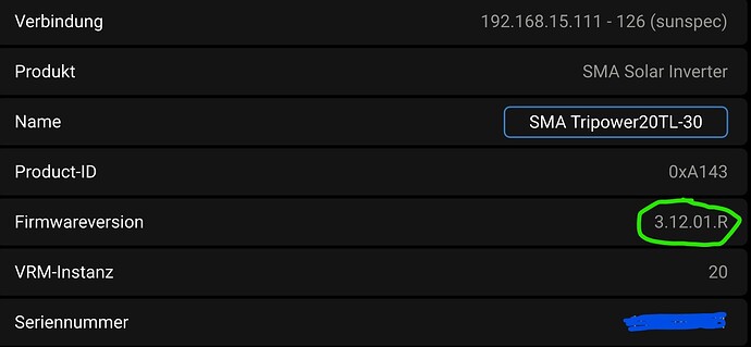

Tested with a SMA Tripower20TL-30.
My Installer activated the external control (using a grid code from SMA) first, then we tested the grid feed-in reduction - which did NOT work at first.
The GX would send the new power values to the SMA (one could see that there were regular updates in the SMA log, for dynamic control settings changeing). However the SMA would not reduce the power/acknoledge the requested power output.
An inquiry with SMA revealed, that the Inverter (installed in 2020) needed an upgrade to the latest firmware - which we did.
After that, everthing works as expected.
SMA Firmware Version, that ist NOT working:
Firmware Version, that IS working fine:
Thanks & kudos to the Victron Team for the good work!
Edit: after updating the firmware, the SMA would no longer flood its log with the “dynamic control settings”, when the GX is actually changeing the Power setting. Looks like this behaviour is another sign, that a firmware update is needed.
