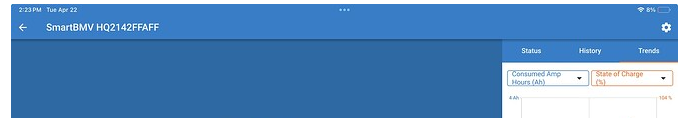

Please can you show the trend for Voltage?
please change consumed Ah to battery voltage, on this trend graph, and see if you can make the graph take more of the screen?
Seems like the change was ~8 days ago, but if anything the battery max voltages seem to be occasionally higher. I would inspect the battery cables from the battery, to the Smart Solar charger, for corrosion, tightness and any other cable damage or hot spots. any circuit resistance is going to prematurely increase the ‘battery’ voltage that the charger sees at it’s terminals, and both reduce charge current and bulk charge time.
