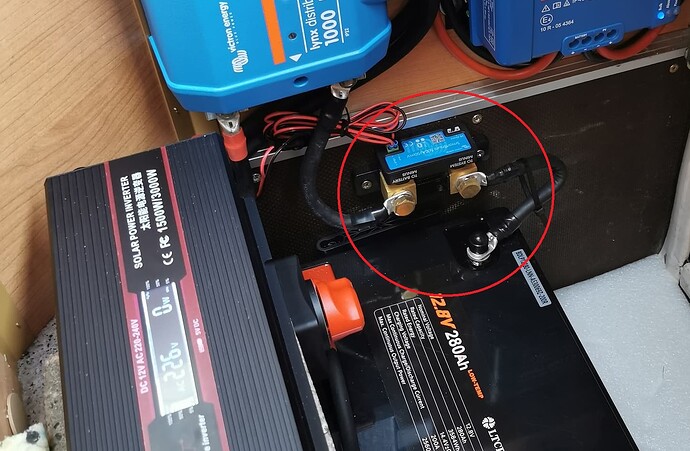

Jumped in … :yum:
without the red Ring …
…and with the SmartShunt in correct position finally.:smile:
Just as on the picture shows in the ‘curtain room’.:slightly_smiling_face:

and you would need to pack your LiPoFe battery a little more
Totally a 007 agent you are🤣
Covering your tracks … :expressionless:
What you wanna do with my battery?:thinking: It needs more curtain or?:smile:
Into a “thermal Box” for more Isolation … Holding the Temperature in the next weeks or month …
5°C … :face_with_spiral_eyes:
I have a temp sensor connected to it so I keep my eye on the temperature.
How does a thermal box work? A bubble folie wrap maybe?
The main thing is to insulate the base and then the sides and lid :thermometer:
A little is better than nothing …

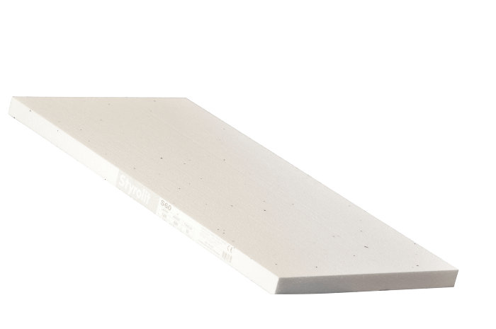

What material you suggest to use?
Styrodur … we say here in “Germany” cuttable and very strong
An Isolation Material for Building …for Floor slabs and foundation insulation
This is the material they use for dry flower decoration as well?:thinking:
It is similar but much firmer …
the Flowerthing is more “Fluffi” :laughing:
Where the hell can I buy that material?
Fluffy :smile:
DIY market … :muscle:
It is this one?
This would be the Danish Version … YES …
Dampspærretape like SIGA for Mounting the corners …
Oki doki. And how many layers do I need to use under, on the side and on the top of the battery? This is 5 cm thick.
