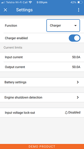

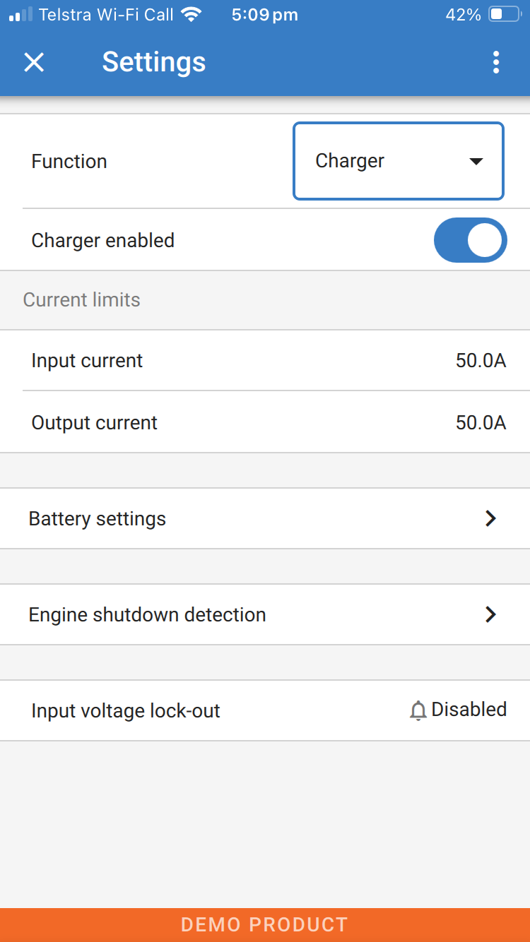

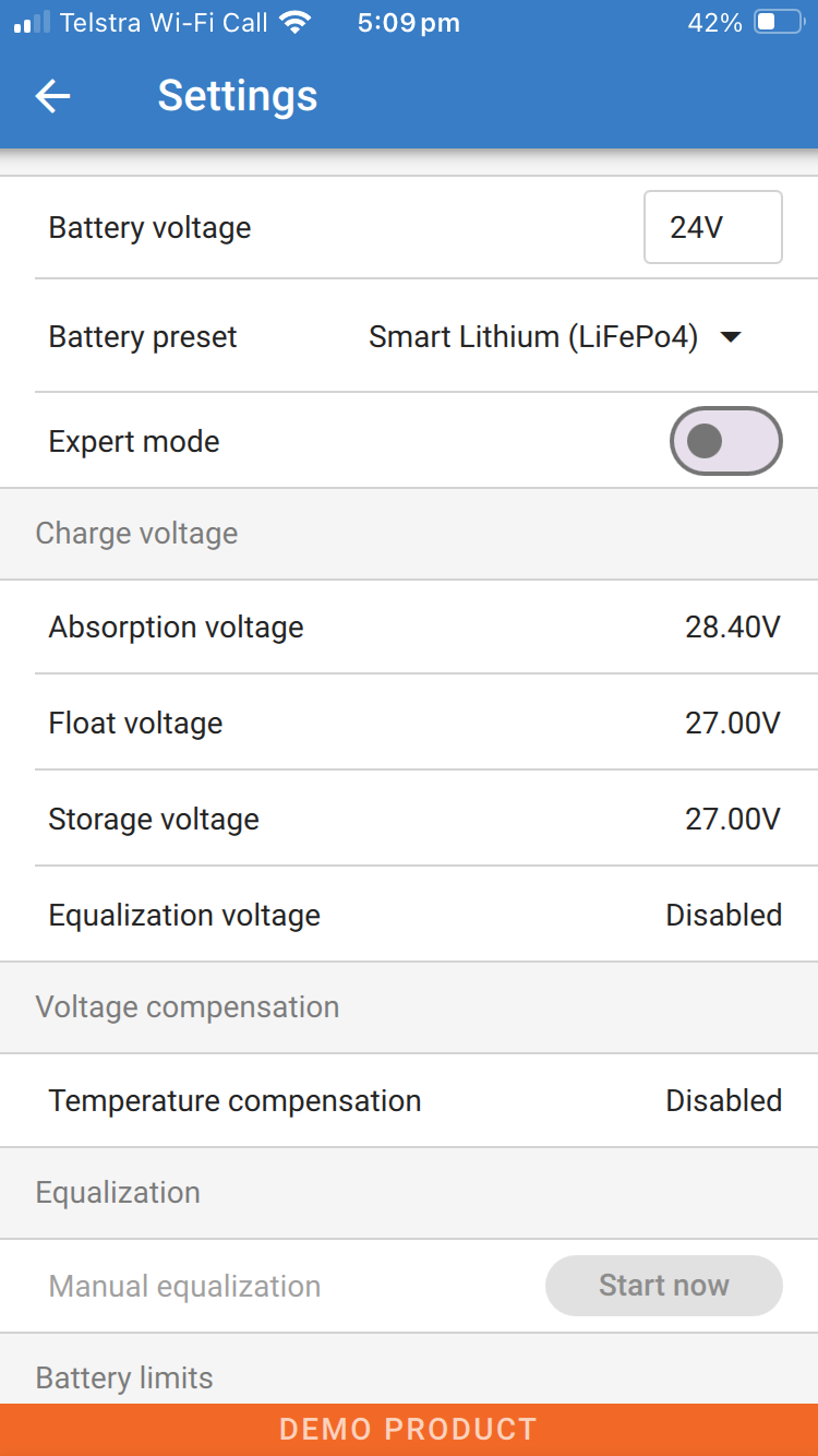

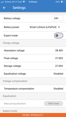

If you get the Victron Connect app, you can look at the products in the demo to see what settings you can use.
XS1400.pdf (206.2 KB)
The Demo Mode of 1400 ignore if you change voltage. Its not helpful in this case
