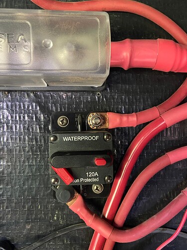

Why does this fuse keep tripping?
Because it is a very poor device. Those thermal breakers, especially the no name cheap ones have a reputation for tripping st much lower current than the quoted value. Many cases on here of this. Many Youtube videos of these failing to work properly. I would not have one of those on my installs.
Replace it with a reputable Brand like Blue Sea or a proper fuse.
