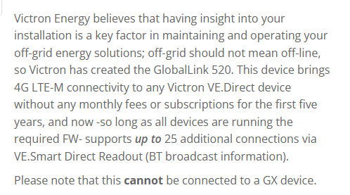

I think most are aware that the GlobalLink cannot be used with a GX device, and it’s noted in the manual(screenshot below); agreed, however, that it should probably be made clearer on the main product page. In some cases I think the marketing/website design team gets a bit ahead of the tech team, which can lead to very important technical details being omitted from the main product page.
