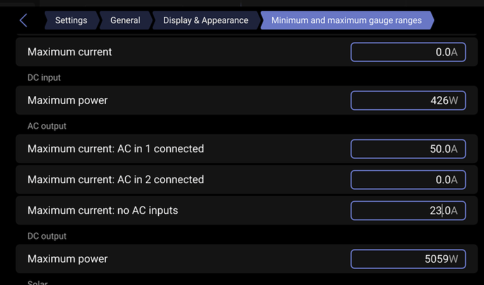

What setting should I use
I have 2 Multiplus 120X2 in parrel. In the cerbo this screen
Should the values be for one unit or the total combined. I am thinking total combined so AC1 Connected would be 100A for a 50A service 50A on each leg a the no AC inputs would be 46A because each unit can do 23 amps.
I just noticed the auto-ranging at the top so if i get to those aps it should adjust. Or is it better to set what they should be.
I use auto range
These setting are only for the bars at the overview pages
