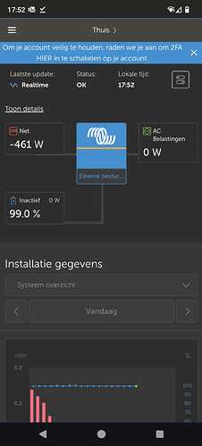

So i just started using my Multiplus 48/8000 since yesterday and i noticed that the setup that i have is feeding back into the grid which is what i want for now. It is correctly displaying this figure real time even with a little graph up there. However it is not logging it in the daily graphs being generated underneath. Im wondering if theres anything im doing wrong here?
edit im using a Cerbo gx mk2, 2 Seplos V4 batteries and i have a bunch of grid tied microinverters from APsystems attached to AC1. Im guessing that is where the issue lies because it’was directly outputting power from those through the Victron
