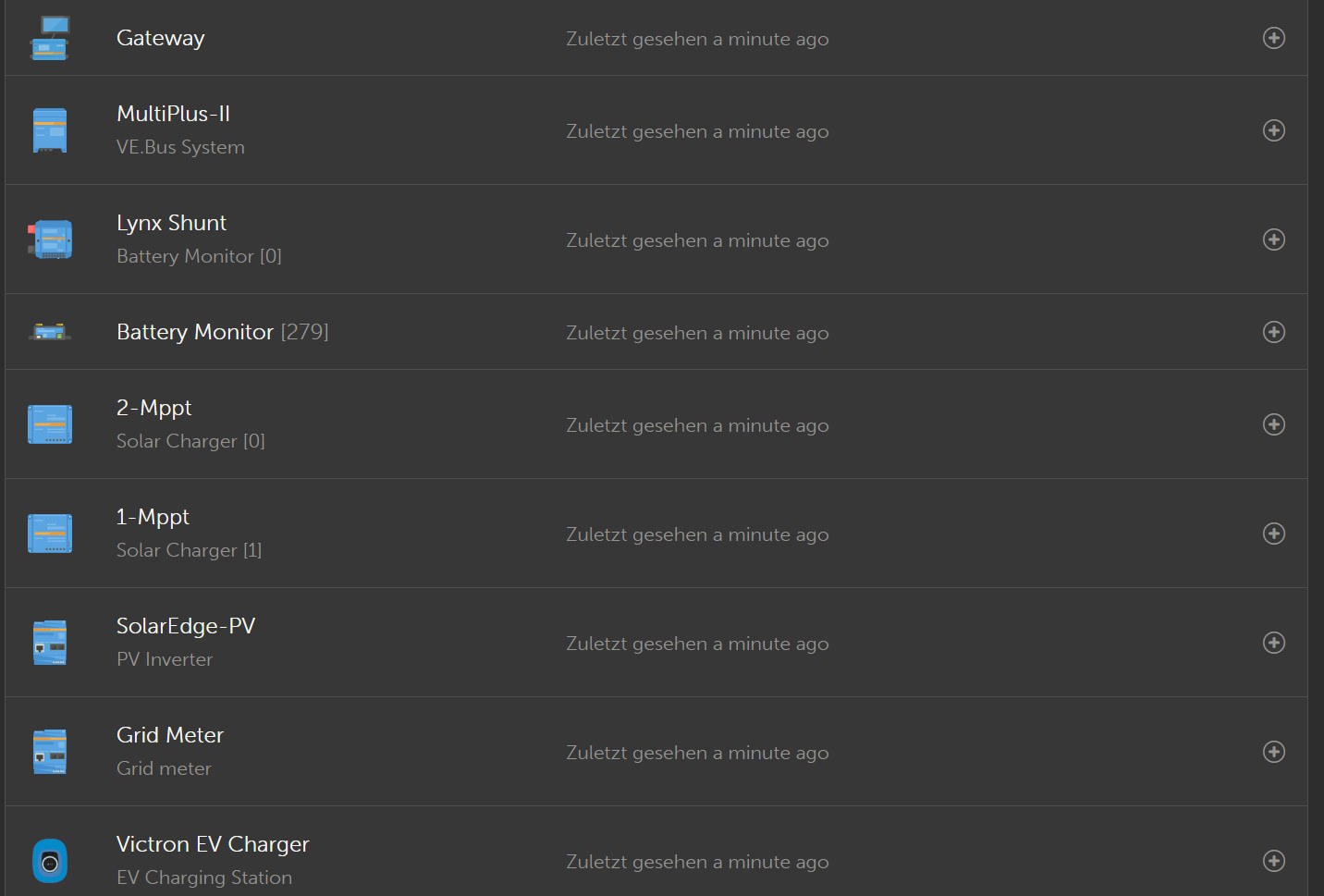

For me CAN is the preferred option. Ethernet downtime is a pain and also appears to be somewhat slower. Having two meters, one for solar and one for grid, is super simpel to implement.
