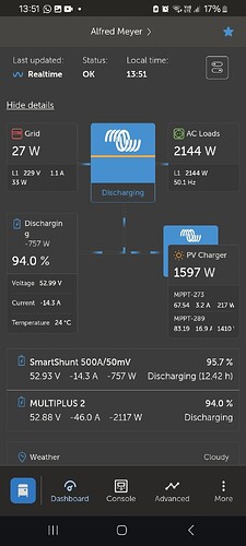

I have a descripency in battery discharge current between Victron Connect and Vrm. Could someone please explain the large diffrence between Multi and Vrm?
I all,
The inverter does not measure current unlike the battery.
Also the inverter will have more than just the battery current moving over its terminals as the solar is contributing to loads.
@lx Ok so if I understand this correctly the Mppt is supplying current xx amount to the battery and the multi will measure the total load summing the current from both sources that is supplied by the multi to the load.Thanks makes sense.
Pretty much.
