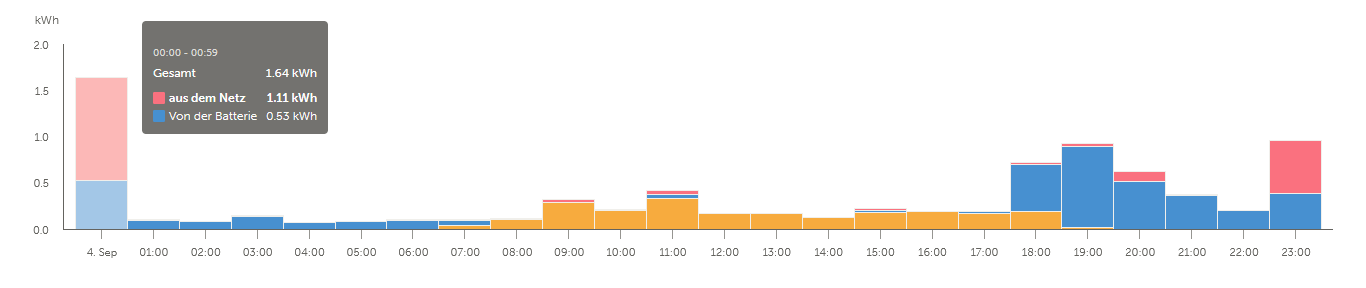

Image: Almost all consumption is covered by AC PV or the Multiplus; only the power for the instantaneous water heater is drawn from the grid in the evening.
