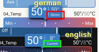

Hi,
during testing switches found a minor bug in translation of “current measurement” into “Strom”(DE) of ”Stroom” (NL).
