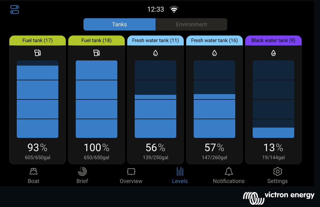

I upgraded to -41 this morning…..A nice to have enhancement for the Levels GUI would to have NMEA Tank Levels include what tank they are for/from. I was super impressed when I connected my Cerbo to my NMEA2K network how quickly you picked up the tank level info but without the specifics of which tank they are for.

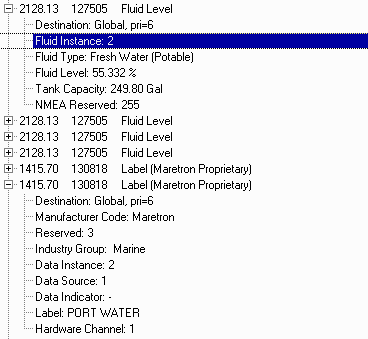

I recognize this is not a functionality that everyone wants/needs and not urgent to me just trying to make you aware if possible for future GUI cleanup/enhancement. IDK how each vendor puts their tank data on the wire (I use all Maretron) but I can see the N2K PGN 127505 is probably the Fluid Levels you pickup and display but unfortunately that doesn’t include a label or description field to tell you where it came from. It appears in the Maretron ecosystem they send PGN 130818 separately that has the label info and you’d have to marry it back to the Fluid Level PGN to get the right labels.
In my case above I have port/starboard water and fuel tanks and only one Blackwater Tank so the generic works fine for Blackwater. It looks like the Fluid Instance field in 12705 is the common field to map to Data Instance in 130818 to get the Label: detail…..

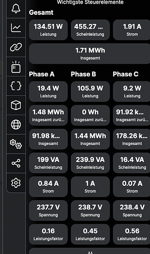

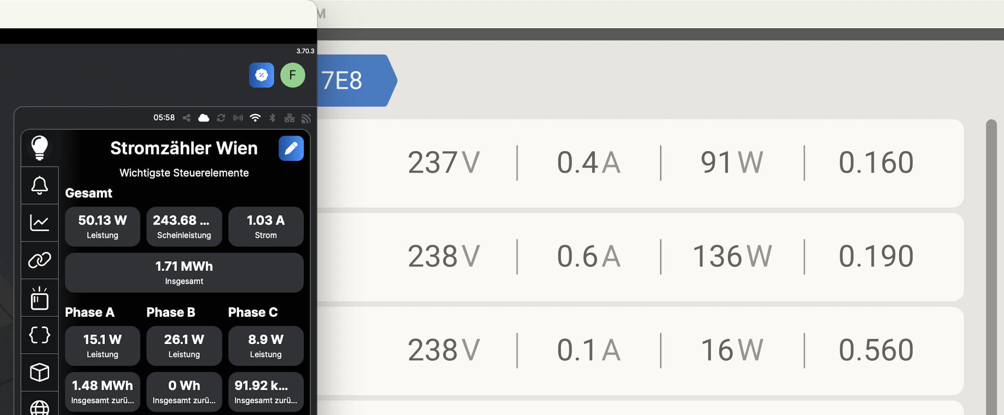

Shelly Pro 3EM is reporting wrong consumption data.
Also, how can I set it to “Grid Meter”?

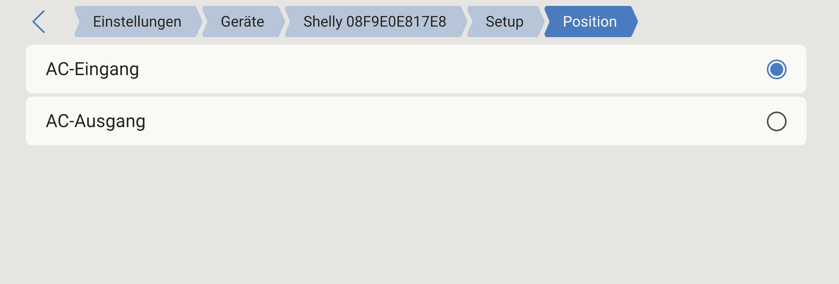

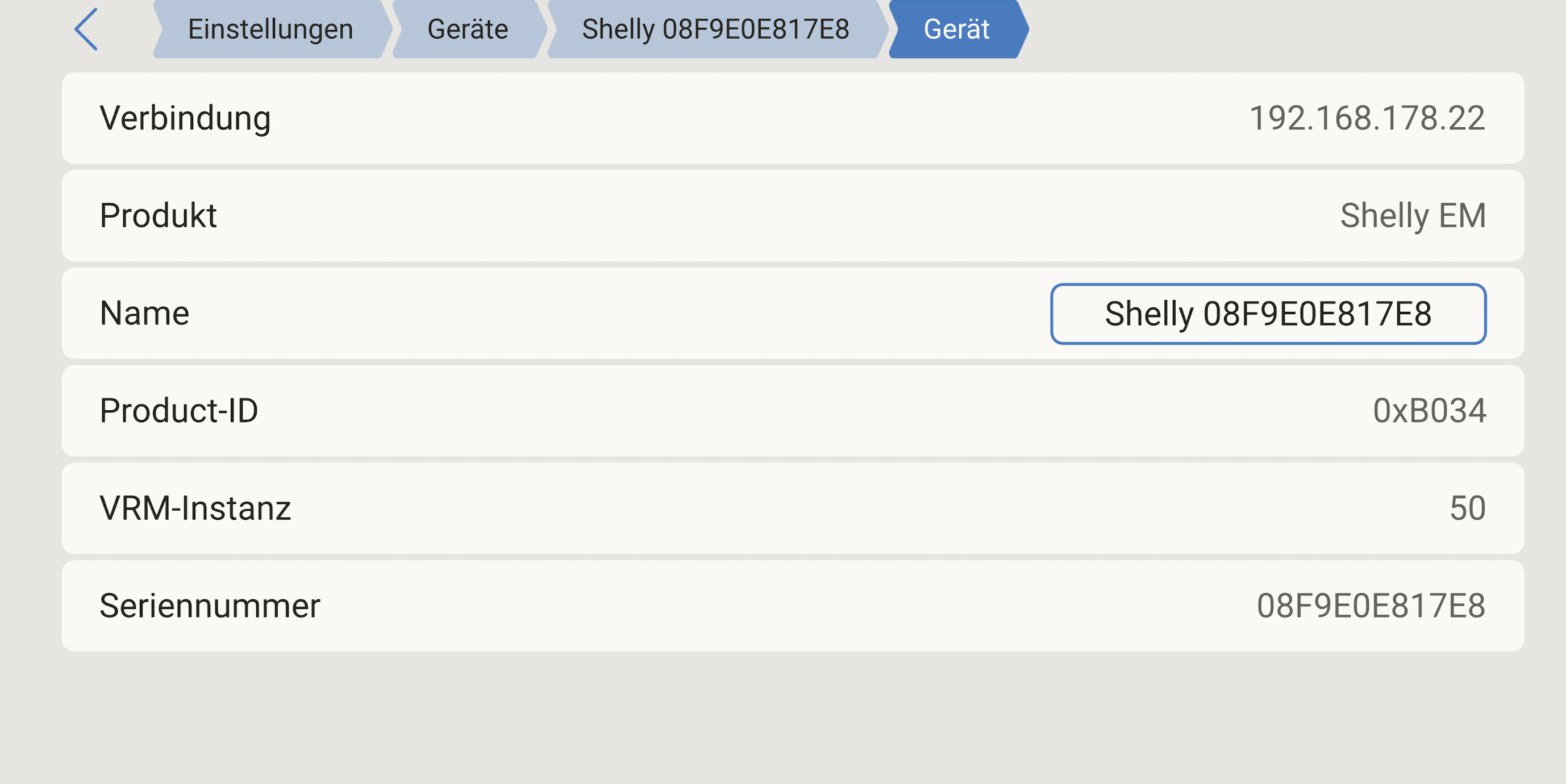

In 3.70 ~45 it doesn’t work to set position for the Shelly 3EM pro. I didn’t test with ~44 - I.e when setting AC input as position its back to unknown when back in setup screen.
This when the Shelly is reporting over websocket since it sits in another vlan compared to the Cerbo.
