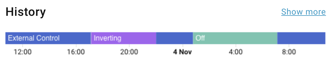

Today over the night Cerbo lost can connection to all devices. I loaded logs /var/log/dbus-systemcalc-py/current and found the following
2025-11-03 22:47:50.208336500 INFO:dbusmonitor:com.victronenergy.multi.socketcan_can0_vi0_uc269838 disappeared from the dbus. Removing it from our lists
2025-11-03 22:47:50.485653500 INFO:dbusmonitor:com.victronenergy.multi.socketcan_can0_vi1_uc260959 disappeared from the dbus. Removing it from our lists
2025-11-03 22:47:50.565887500 INFO:dbusmonitor:com.victronenergy.multi.socketcan_can0_vi2_uc259646 disappeared from the dbus. Removing it from our lists
2025-11-03 22:47:50.646755500 INFO:dbusmonitor:com.victronenergy.grid.socketcan_can0_vi0_uc440792 disappeared from the dbus. Removing it from our lists
2025-11-03 22:47:50.749803500 INFO:dbusmonitor:com.victronenergy.acsystem.socketcan_can0_sys0 disappeared from the dbus. Removing it from our lists
2025-11-03 22:50:41.632511500 INFO:dbusmonitor:com.victronenergy.vecan.can0 disappeared from the dbus. Removing it from our lists
2025-11-03 22:50:41.927738500 INFO:dbusmonitor: com.victronenergy.vecan.can0 has device instance 0
Time is UTC.
In system there are 3xMultiRS single tracker version, MPPT 150 and Pytes stack with 8 batteries on BMS can (fw version 1.5.40.C8)
Cerbo restart fixed the problem, but the behavior is strange. Any ideas? I can give any other logs from this list

To add a bit: whole system went to off state of course, never tries to re-scan can bus
Also adding can port network stats
