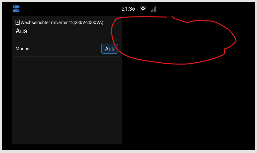

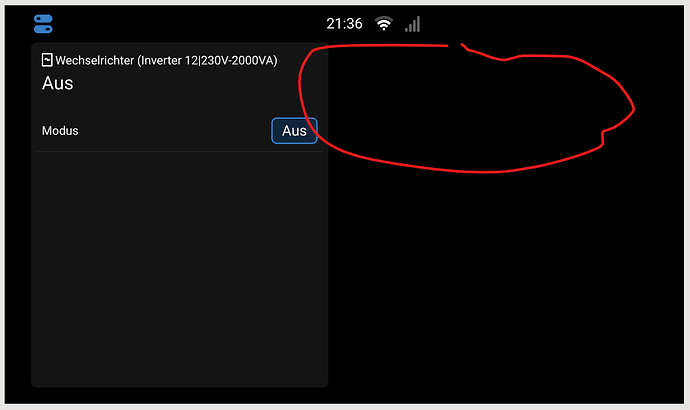

When activate a virtual switch, delete the relais button in the overlay
When delete the virtual switch in node-red, these do not disappear in the overlay.

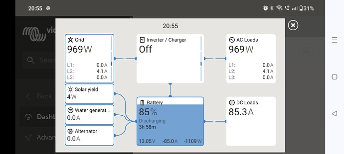

After I installed the new beta version the VRM no longer showed realtime, the grid of devices that show the power flow no longer had the moving worm things. It also did not give the option for remote console. I rebooted a few times and still no realtime VRM. The time to go which in the last beta was off went back to normal but I reverted back to the previous version in memory because I was not able to see in real time what was going on remotely.

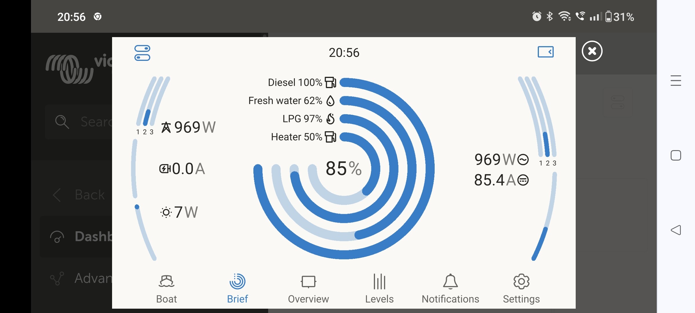

Very happy with 2 updates on v3.70~5.
Being able to show 3 DC sources is great.
Also having 4 tank levels as well as battery % in centre is ideal.
Looking great!

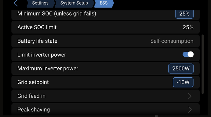

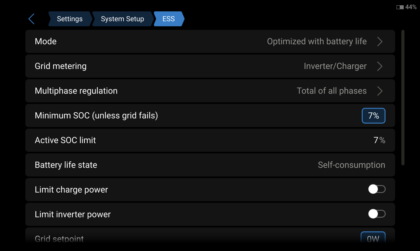

In the new ui I’m missing the maximum charger power which was available in the old interface before 3.60
4 posts were split to a new topic: V3.70 beta DYNESS issue?
Working here. Depending on other ESS / DESS / Inverter settings this option may not be visible
Strange, I had this setting before and I can still control the charging power with node red.
