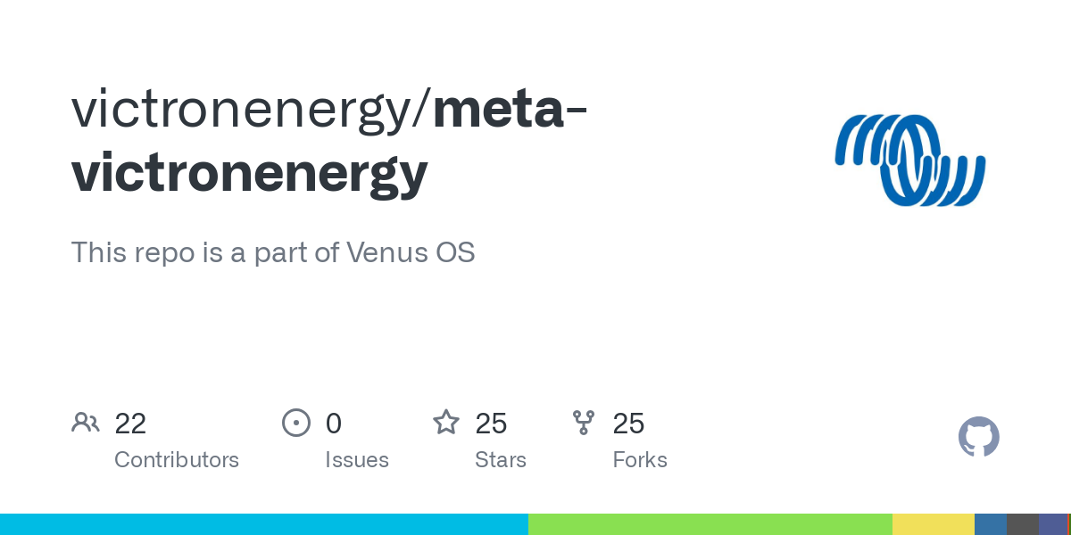

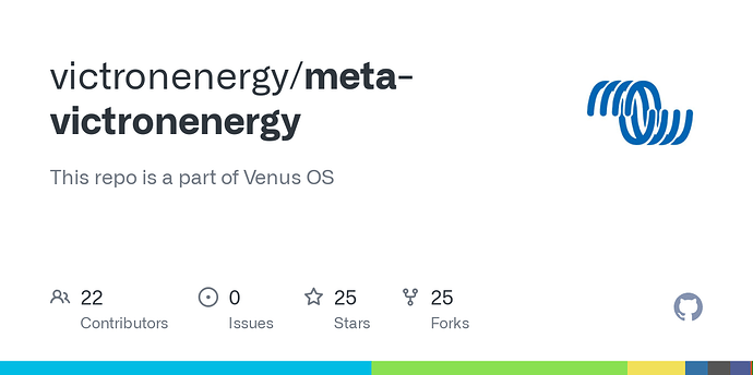

@Oooliver
as a dev, maybe look into GitHub.
Repo meta-victronenergy seem to contain the Venus OS releases as tags and release candidates seem to be on master.
