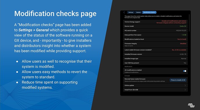

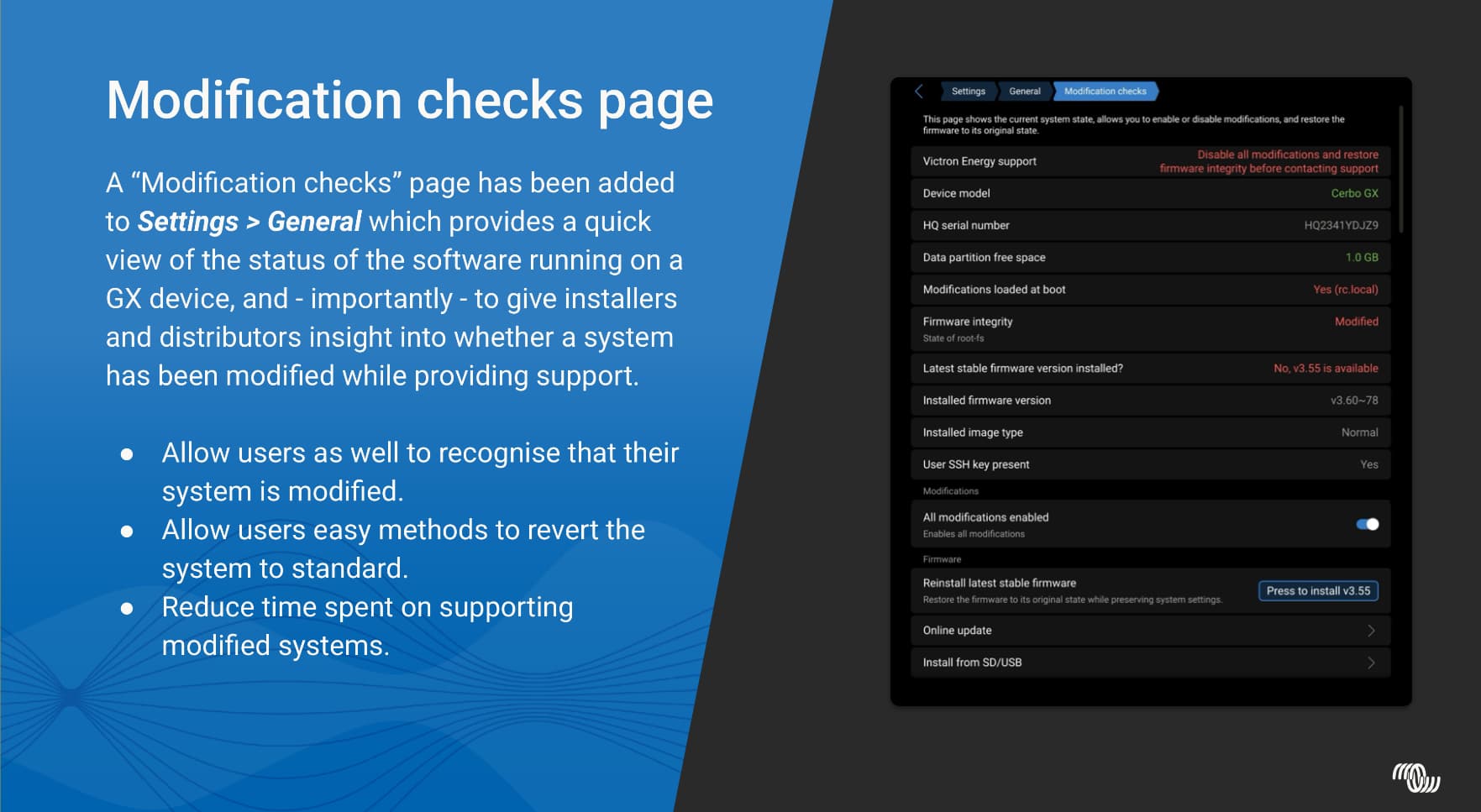

To disable all plugins, including jkbms in your case, without having to go there yourself and doing things over ssh or usb sticks, you can now do this:
  1. in new UI, disable the loading of modifications at boot. See Settings → General → Modifications
  2. Click the reinstall a clean version button
For details, see below slide in public - Venus OS v3.60 Release - Google Slides.
Matthijs
