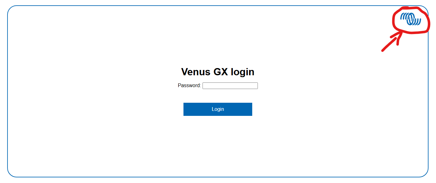

I need your help please. I am running Venus OS 3.51 on an RPI. When trying to login via web interface then I am getting stuck on the login screen.
After entering the correct password the Victron Symbol on the upper right flashes once then nothing happens and the login screen is still shown.
