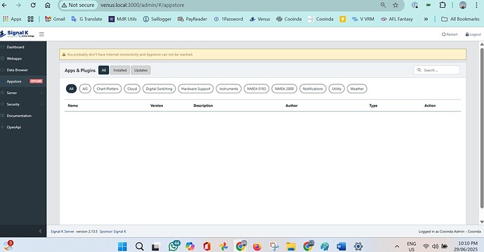

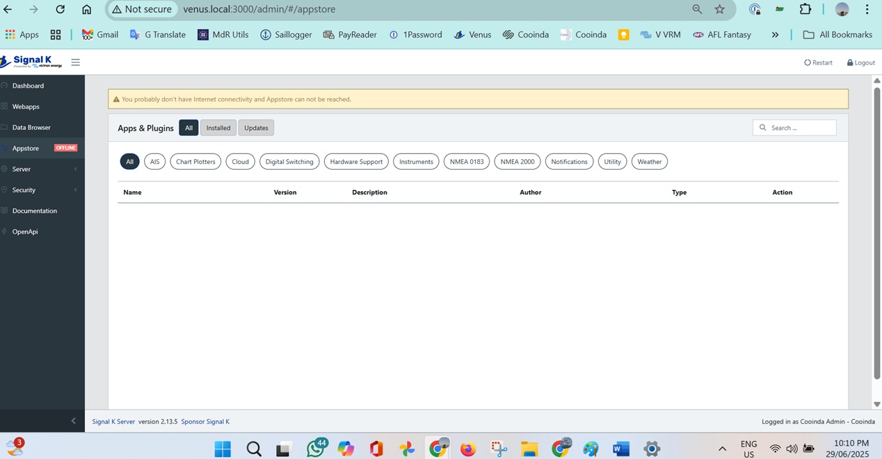

I am having issues with 3.62 as well with SignalK. With an update to 3.60 I lost SignalK internet connectivity and get SignalK Appstore Offline. A rollback to 3.55 restored connectivity and the Appstore. I reset SignalK to restore all settings to basic then updated the preloaded apps then updated to 3.62 again and have the same outcome with no Appstore or connectivity. I posted the 3.60 issue but had no replies to repair the situation. I would appreciate some Victron assistance.
Thanks.
Do you perhaps have the GX device ethernet port in use for a non internet connection such as energy meter and wifi connection for internet? As in that case this might explain it:
(Solution is to set gateway of the ethernet connection to 0.0.0.0)
Thanks. I will try that. It is perverse though that there is no issue with 3.55 and previous updates.
This is because changes were made to dual ethernet / wifi in V3.60, all coveted in the changelog and slide pack.
Thank-you PWFarnell. A full day of ops and a couple of reboots to check and all is well. I am very grateful for you taking the time to respond with a working solution. I did view the slide package but didn’t pick up on the ethernet and wifi connection change with the issue seeming unconnected in context. My bad.
