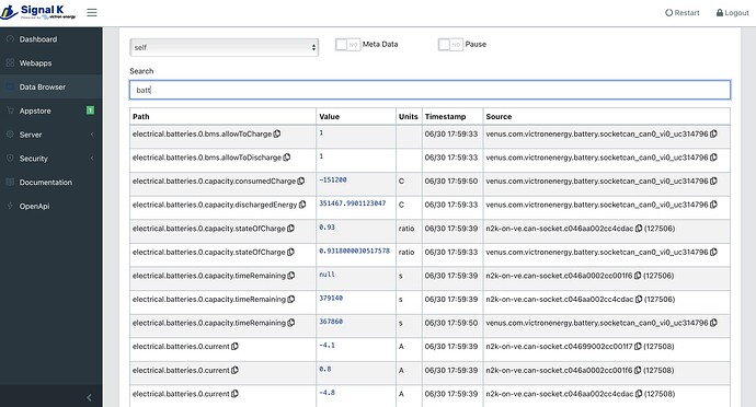

When connecting to nk2, source are identified completely differently than I’m used to. I’ve compared it with another installation and the settings on ve.can port are identical as far as I can see.
I’m trying to add filters and blocklists, but I’m having trouble referencing the source when I can’t enter the number I’m used to (like 224). I need to resolve this due to conflicts with pgn so would be very happy if someone could point me in the right direction.
Cerbo gx OS V3.62 Large
Problem solved. Restarted the entire n2k system, started one by one the units and filtered out a lot of data. Restarting Cerbo did not help. Not sure what caused this missing addressing. Hypothesis is data overload, but this is just speculation as I can’t find any other explanation.
