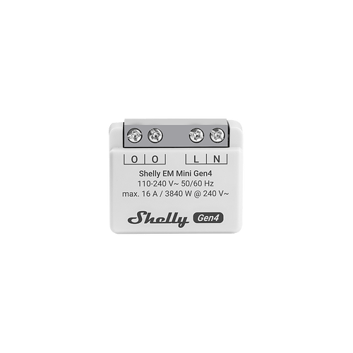

My Shelly EM Mini Gen4 (1.7.0-miniemg4prod0) isn’t working, my other Shelly devices are recognized and working fine.
What could be the problem?
It looks like shellies with authentication turned on are not discovered. At least that’s what my experiments seem to show. Can someone confirm that?
My gen3 PM minis are not found either, while gen3 1PM minis are found correctly. They have basically identical configs. No authentication differences.
Gen3 PM mini is very similar to Gen4 EM mini. Seems like the discovery algorithm misses some Shelly models.

Yes this is correct. When a Shelly device is secured with a password, it can also not be probed so it won’t show up in the discovered devices list.
We have the ambition to support secured Shelly devices as well, but currently it is not supported.
