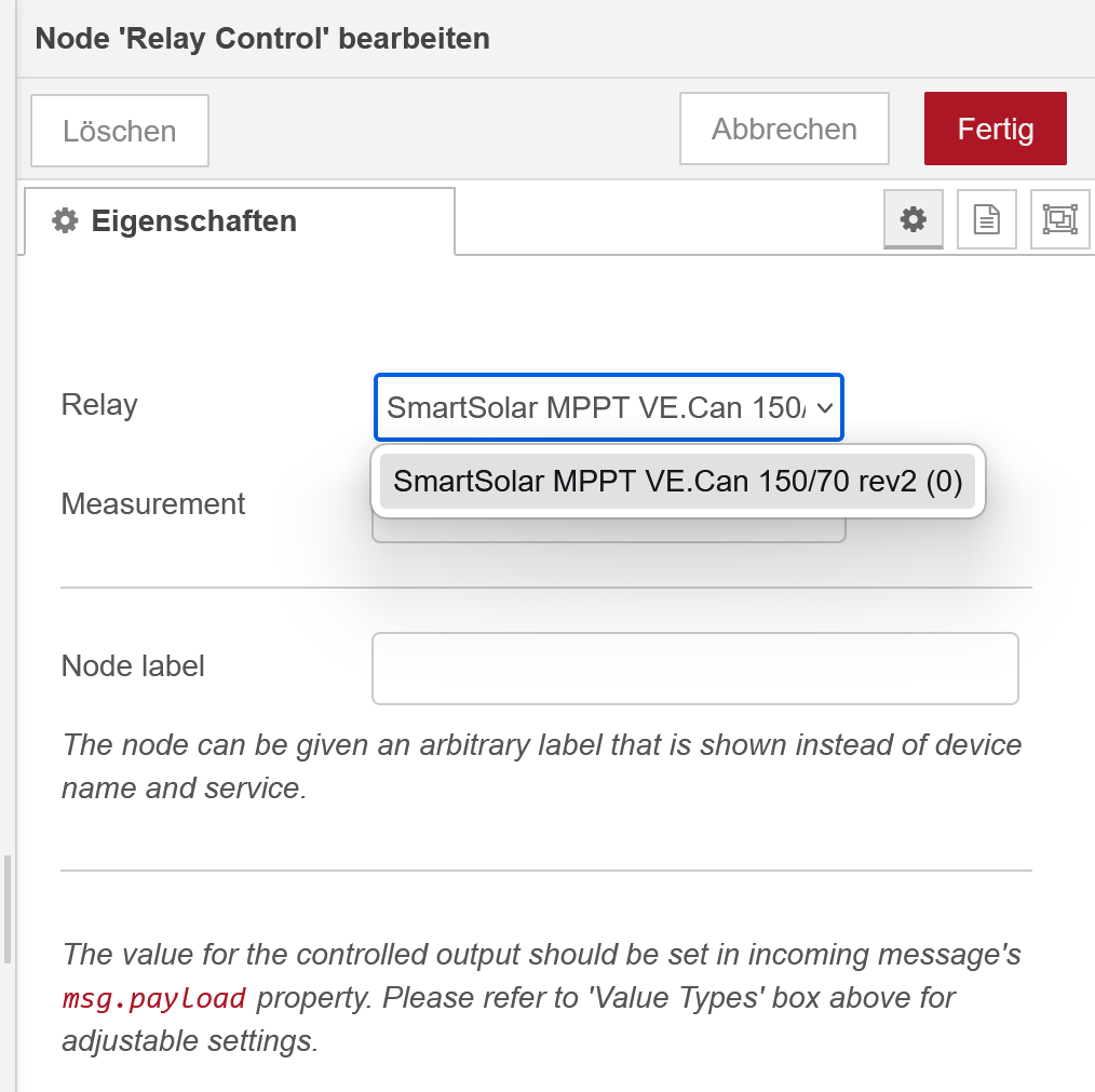

My Ekrano does not show up in the dropdown-list of selectable devices with relays, only the MPPT shows up:

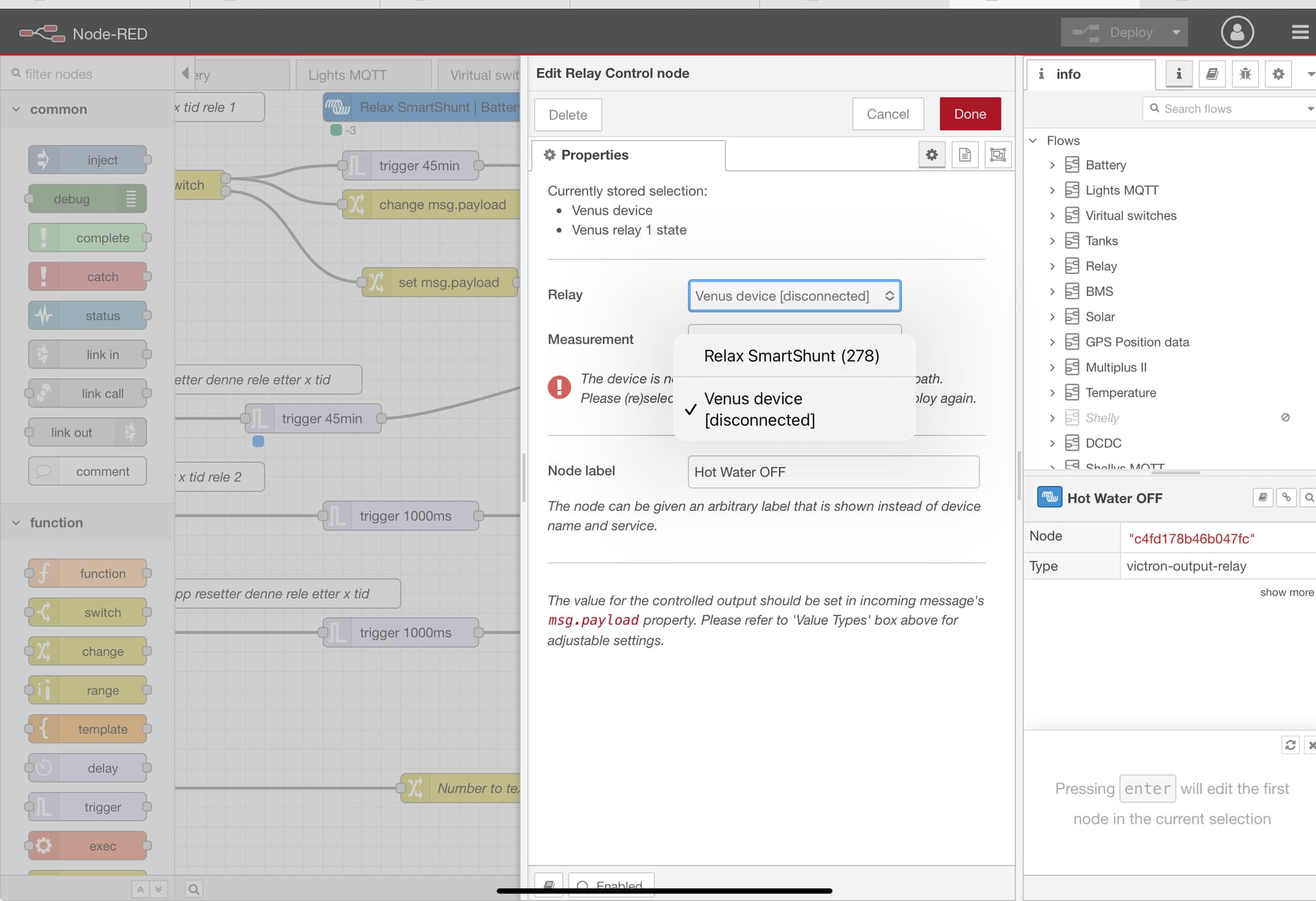

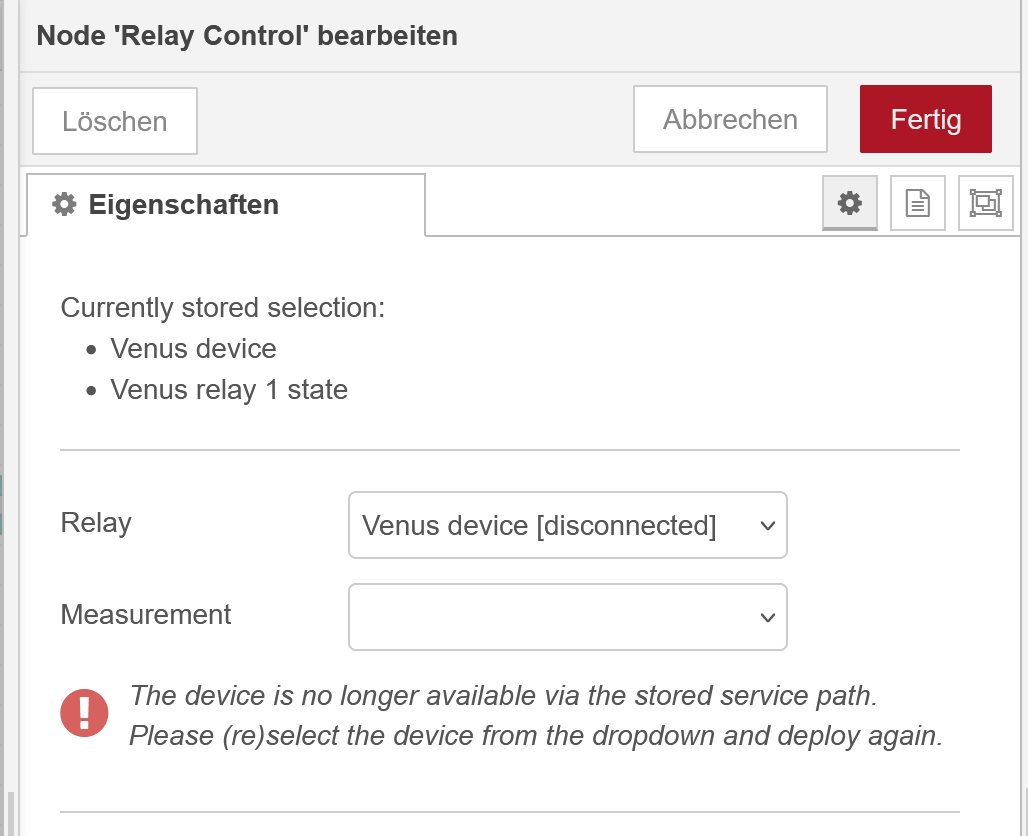

on an earlier installed “Relay Control” node, the Ekrano_GX (aka Venus device) disapeared:
Rebooting the device did not solve the issue.
Reverting back to v3.63 solves the issue, “Venus device” reappears:
Let me know if further information is needed and I will have an eye on the beta testing change log if it is adressed as fixed in a further revision.
