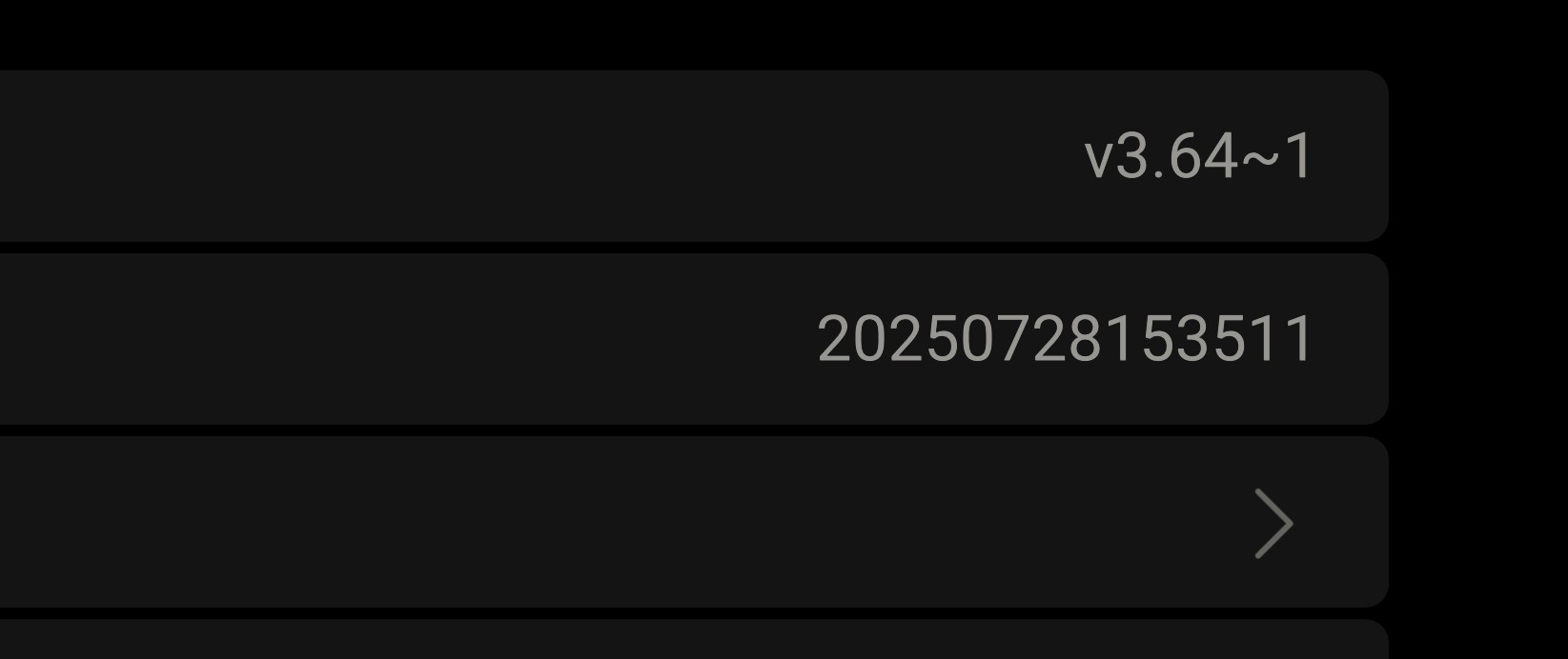

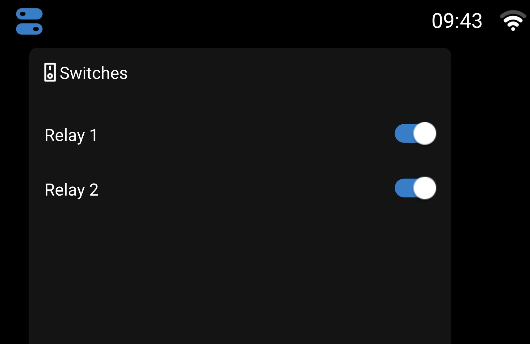

Hi, Just updated GX and it went to Beta V3.64~1, the two Relay button selectors has now gone, and it shows one selector, but the relay screen has gone back to the old style with no names or GUI buttons.

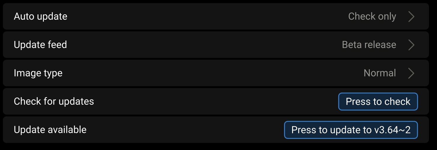

Correct Sherlock, but for some reason you cannot download 3.70 beta, see below the latest version it shows you is available via beta which is 3.64~2, so something is not sync’d somewhere, either on my side or Victron’s side, I had 3.70~21 and when it updated, the OS went back 3.64~1 ?

unfortunately I also fell for the fw 3.64~1!
