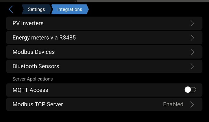

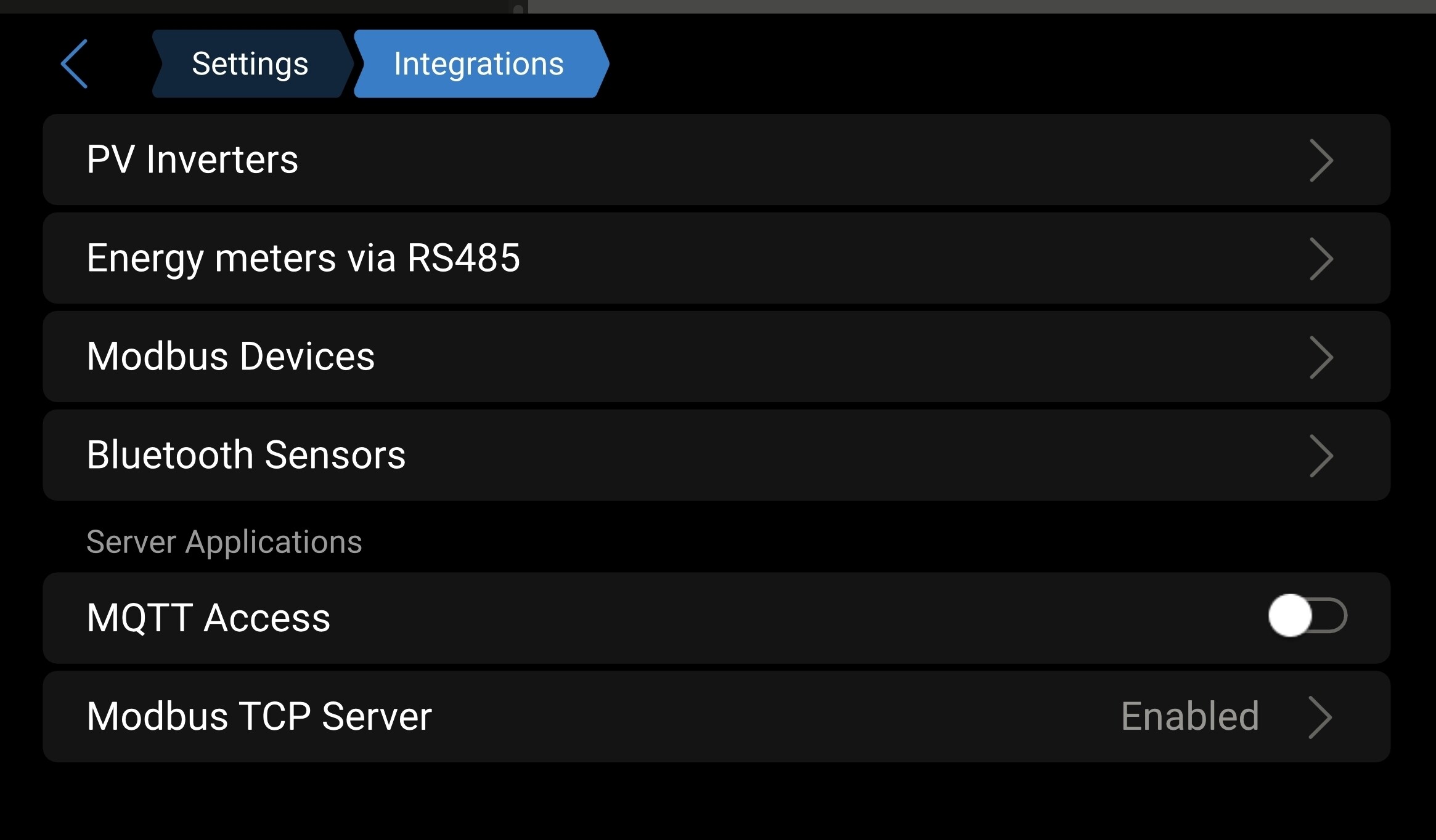

HI i have found that after updating to V3.60 the relay functionality of the color GX and MP2GX have disappeared - i have rolled back to V3.54 and they are there - all 3 of my devices it affected - i use the relay to restart a internet router when the internet goes down by using the reboot function of the GX on loss of connection which in turns resets the relay (pic showing V3.54 v V3.60) and the new GUI is the same - Also manual generator control gone

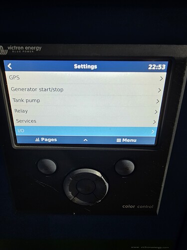

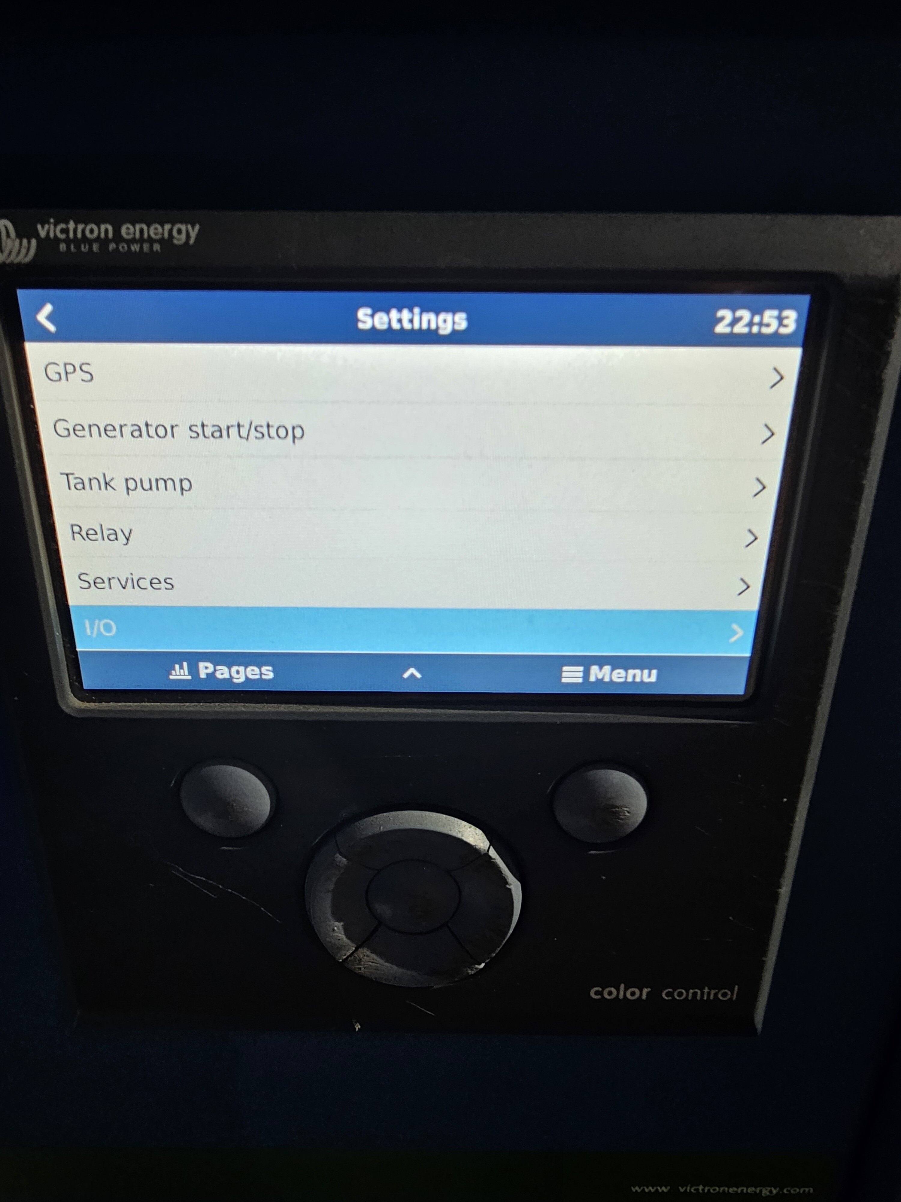

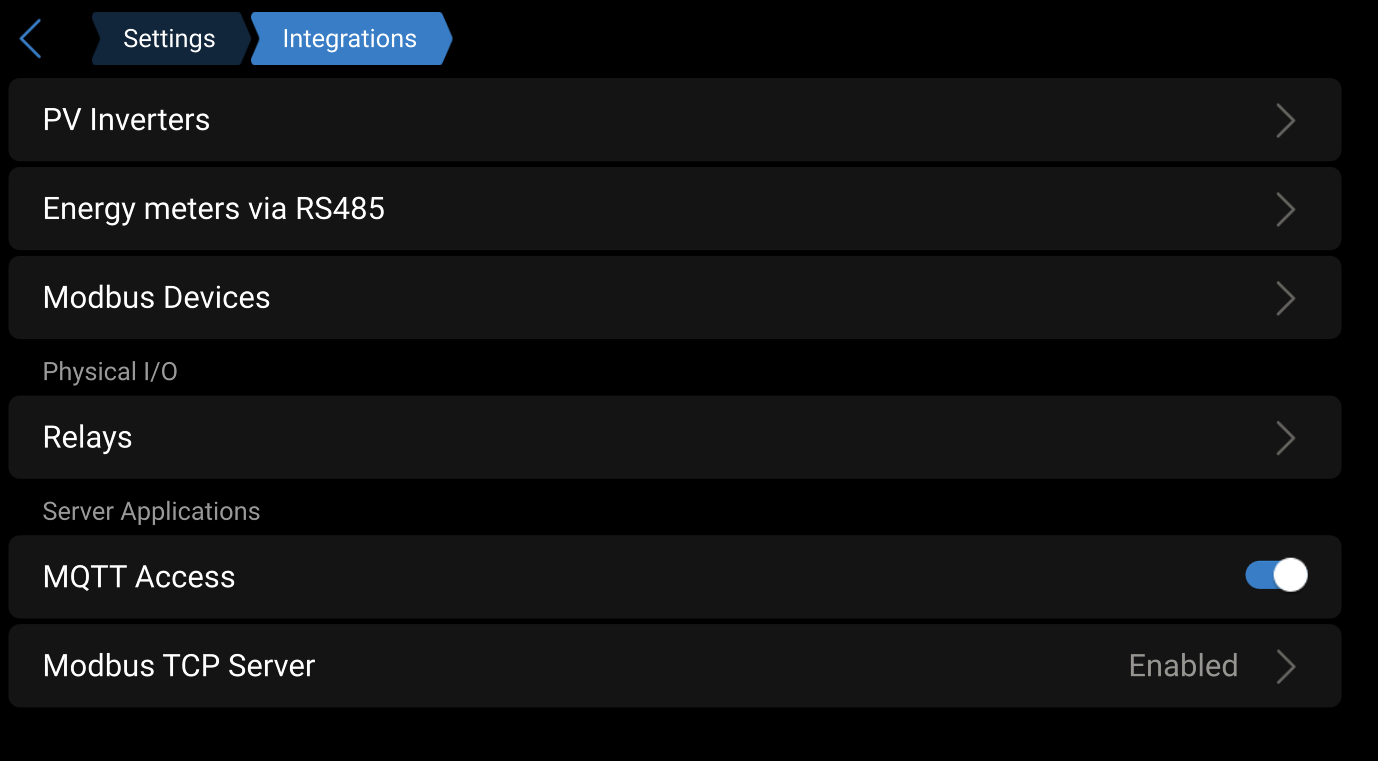

Real strange, this is a screenshot of the menu of one of our CCGX-es, showing the relay entry as expected:

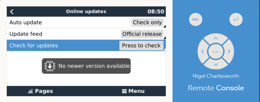

i just did an online check to see the new update and it appears the update is now not available

Its currently on v3.55 and it appears that the update back to V3.6 is no longer available ..but if I lose that relay function I lose the internet with it
(attachments)
It is definitely still available for update. But you should also be able to boot back into 3.60 from the backup firmware menu.
