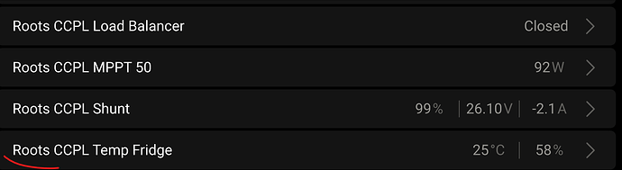

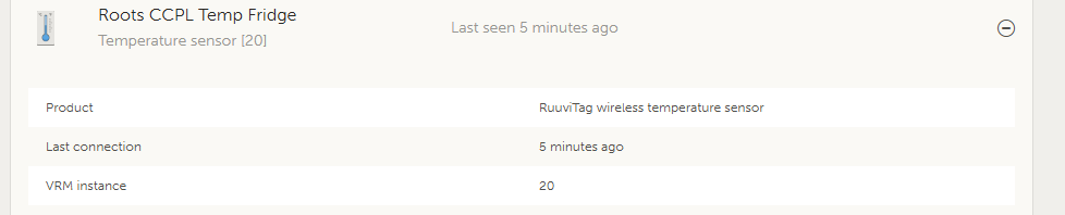

If I check the screen remotly (VRM or from web browser) I can see the Ruuvi sensor !
If I check it directly on the device, I can see it in BT settings, but not in devices or Enviroment !
So what could be wrong ?
