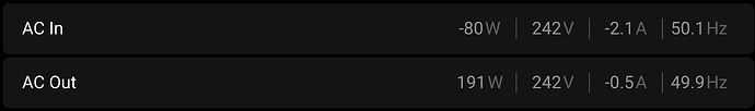

I recently fixed a broken generator. Plan on using it with my multiplus. But my multimeter doesn’t have a frequency meter.
How accurate is the frequency/hz meter on a Victron Multiplus (12/1600/70-16)? Will it try to jump between 50 and 60hz, or will it show a more accurate reading. (so I can dial in the engine RPM/get a correct frequency on the AC power)
Can’t easily test, because the Multiplus is some distance away atm/if I can’t, I’d rather keep the generator here and find some other way to measure hz.
@Jahee As per the specification sheet the charger input range is 45 - 65Hz and it will be displayed in increments of 1 decimal point. It should serve your requirements. Outside of this range the system will obviously not connect to the source. The output Hz is accurate to within 0.1%.
